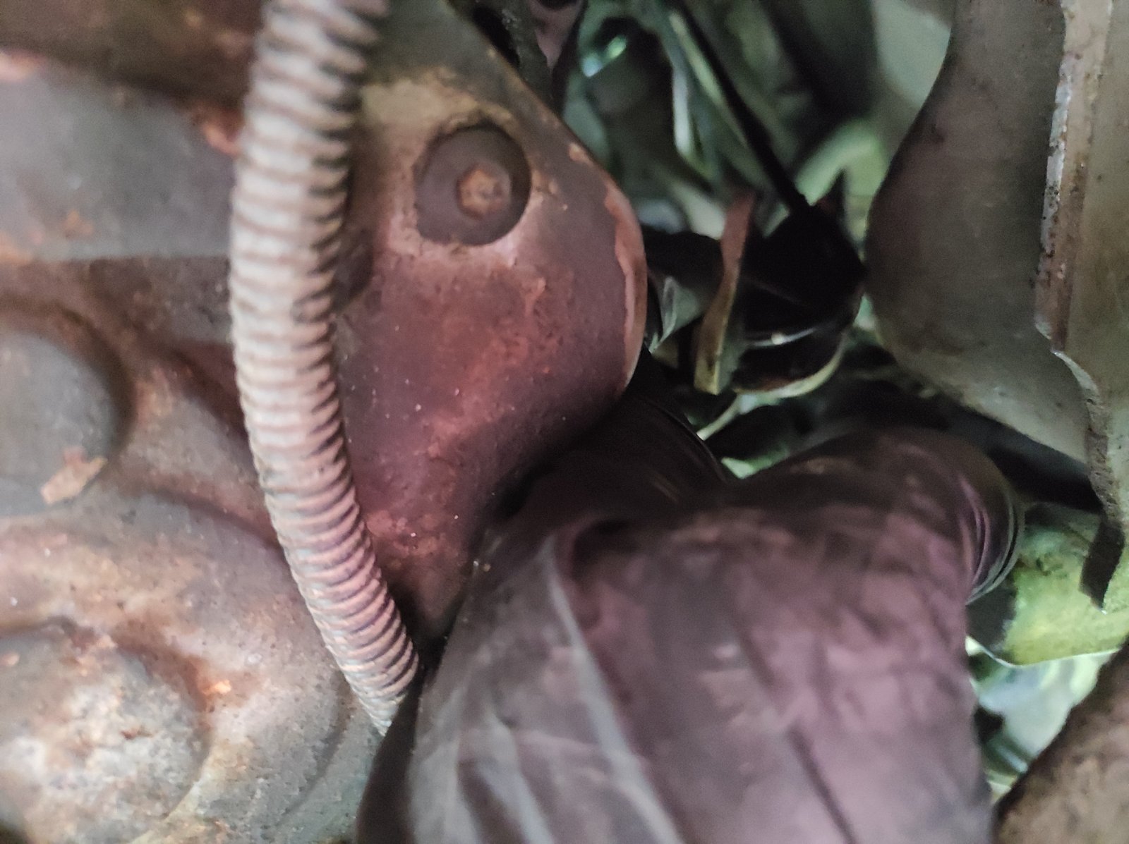

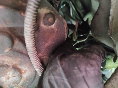

It's at the back of the gearbox beside the wheel arch I'll take a picture when I get home from work. It seems to be a self contained system. It's not the ones like a coolant sensor if you know what I mean.

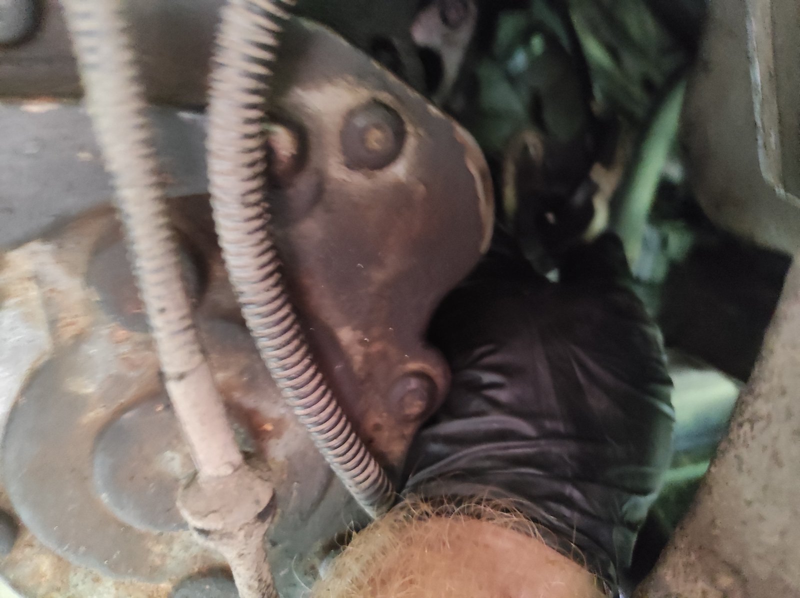

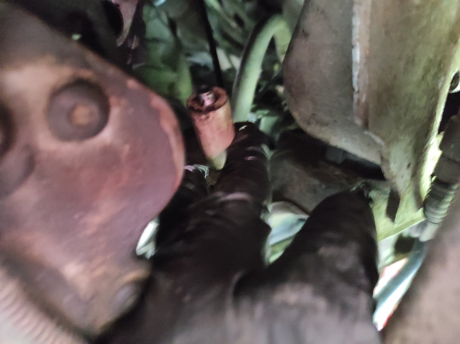

Re: Reverse light won't go off
I have a couple of photos there not great because my paws are too big to get in there with the camera. It's connected to the spring on the selector in the cockpit aswell.

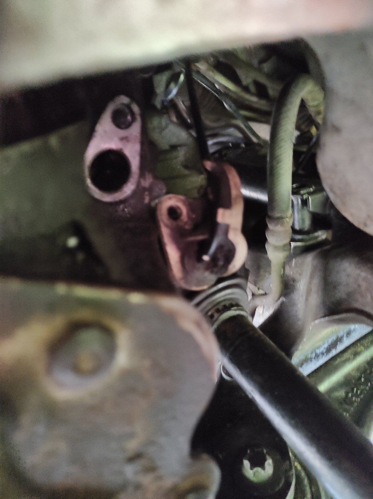

Dont think thats the reverse light switch, just looks like the reverse lock to me unless im missing something. Should be a 2 pin connector for the reverse light switch. Its normally on the top of the box accessed from under bonnet.

Hi wheeler, I am not great with gearbox end of things. I thought it was the switch sorry lads being a numpty again.
That will be a much less stressful fix. Thanks a million.
