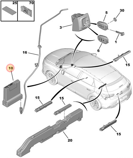

(10) ADML Electronic Unit, part: 1608421980, £414.61
(Will need Configuring)

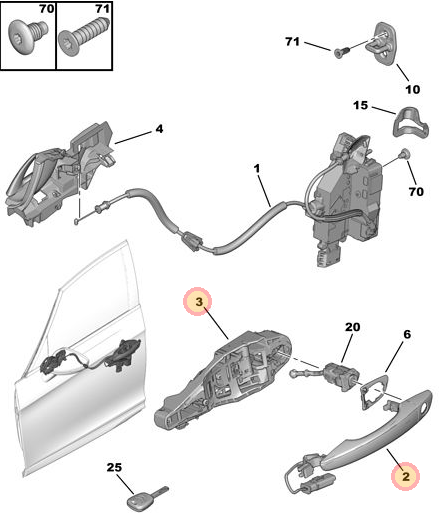

Door Handles
(2) Door Handle Left, part: 967853211T, £189.35
(2) Door Handle Right, part: 967853191T, £189.35
(Note, holes to be painted)
(3) Door Handle Holder Left, part: 9678781580, £68.16
(3) Door Handle Holder Right, part: 9678781480, £68.16

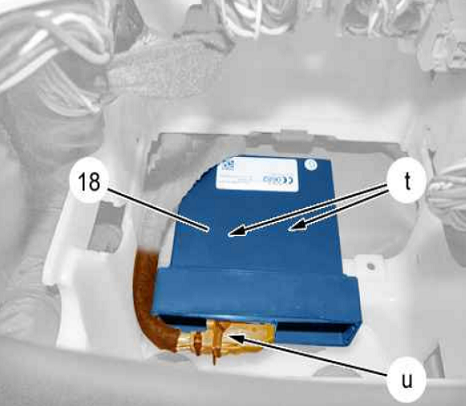

Re: DS5 problem with keyless entry
The Hands Free ADML unit is a pig to get to and requires on a left hand drive that the whole upper and lower trim on the driver's side is removed, the BSI is removed in order to get to it at (18). It is not designed to be easily accessible for obvious reasons.
Just be very careful in this area as there are a lot of electrical connections that are very sensitive, so don't put any stress on any connectors or wiring.
