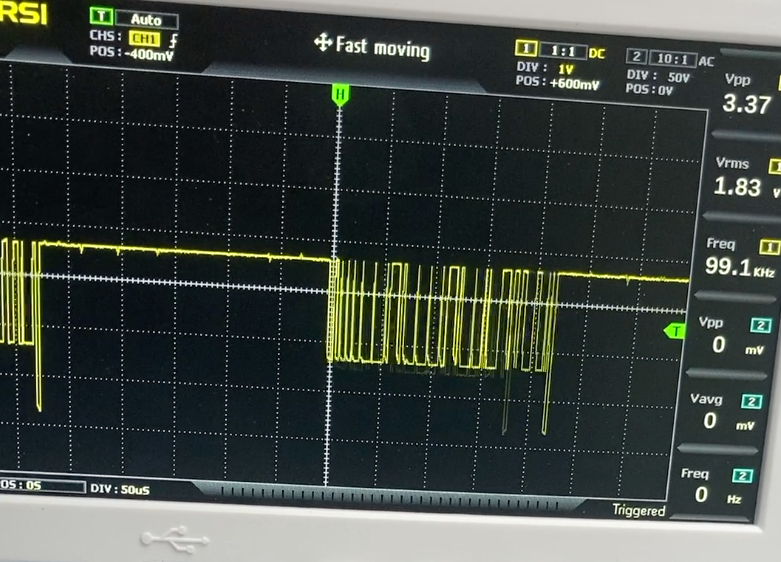

In a 2007 C5 Hdi 2.0 I have 'Power Steering Faulty' showing up with heavy steering, so I assume the pump isn't firing up. Lexia diagnostics tells me 'No Communication with ECU' with the electro pump ECU.
When I back-probe the com lines at the electro pump ECU I can see the signal below, so I don't know if perhaps I have a bad ECU or if the BSI is sending bad signals, because I don't know what good signals should look like.
Anyone have experience with this kind of issue?

After trying a new battery I got miserable because it changed nothing. The electro pump and its ECU are receiving healthy well over 12v but no response on the coms lines.
Do these ECUs tend to die? I tried finding one a used one but so far no luck for this model. Repairable perhaps?

I'd first be looking at the wiring connections on the pump.
