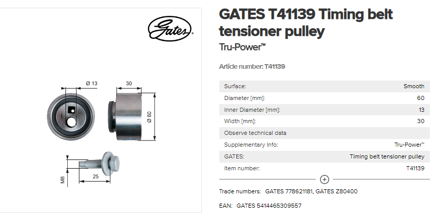

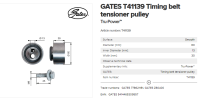

Opened it up and noticed that the tensioner pulley is a Gates T41139 found here:-
https://www.autodoc.co.uk/gates/7957270

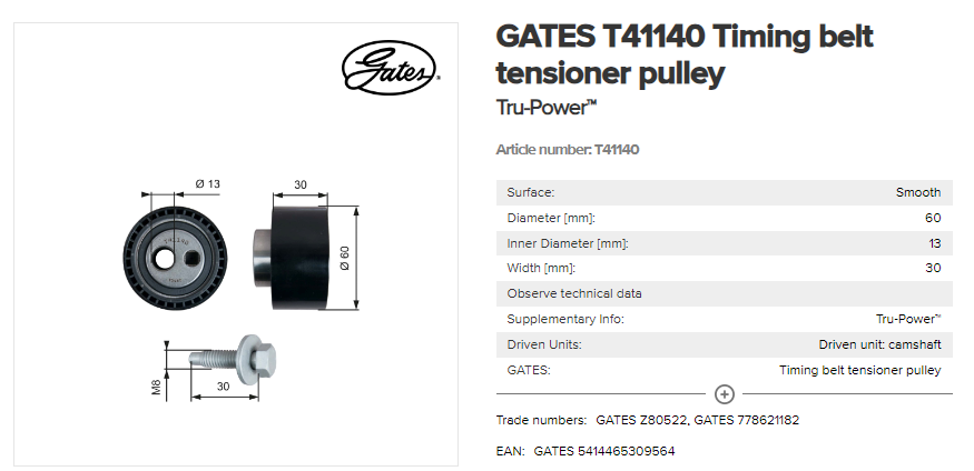

as opposed to the T41140 here:-
https://www.autodoc.co.uk/gates/7675155
which to all intents are purposes is exactly the same surface and dimensions as the correct one as specific as part of this kit with the correct reference number:-

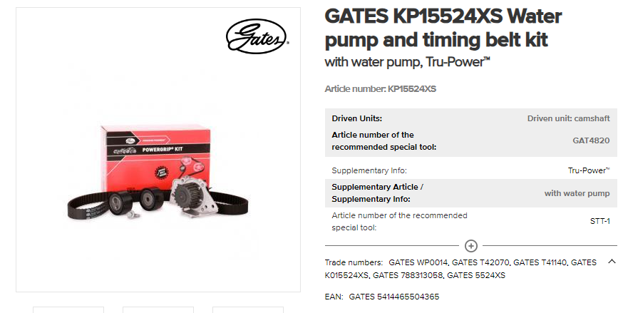

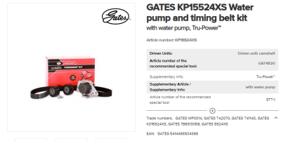

Complete kit which shows a T42070 idler pulley - you can see all the part numbers a KP15524XS kit should have - but the supplied kit contains an INA affair (which I have yet to check dimensions on).
https://www.autodoc.co.uk/gates/7025612

There is a difference in the first 2 pics you showed - namely the M8 bolt! One's 30 and the other 25. Any difference in 'a kit' which includes any included component parts, requires a different part number for the kit. Otherwise they would be paying a fortune in refunds and returns because the wrong size bolt was included.
I can't tell if there are other differences from the pictures, but that's one reason.

Good spot Marc.
As it was missing the bolt, I didn’t bother to check as I’ll have to re-use existing. Maybe worth cleaning up and putting a dob of threadlock on it.
