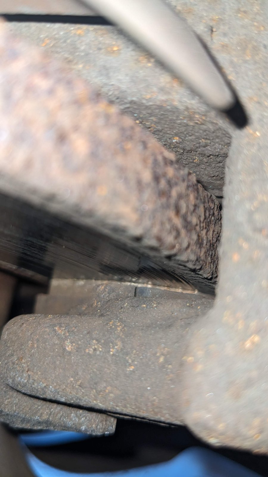

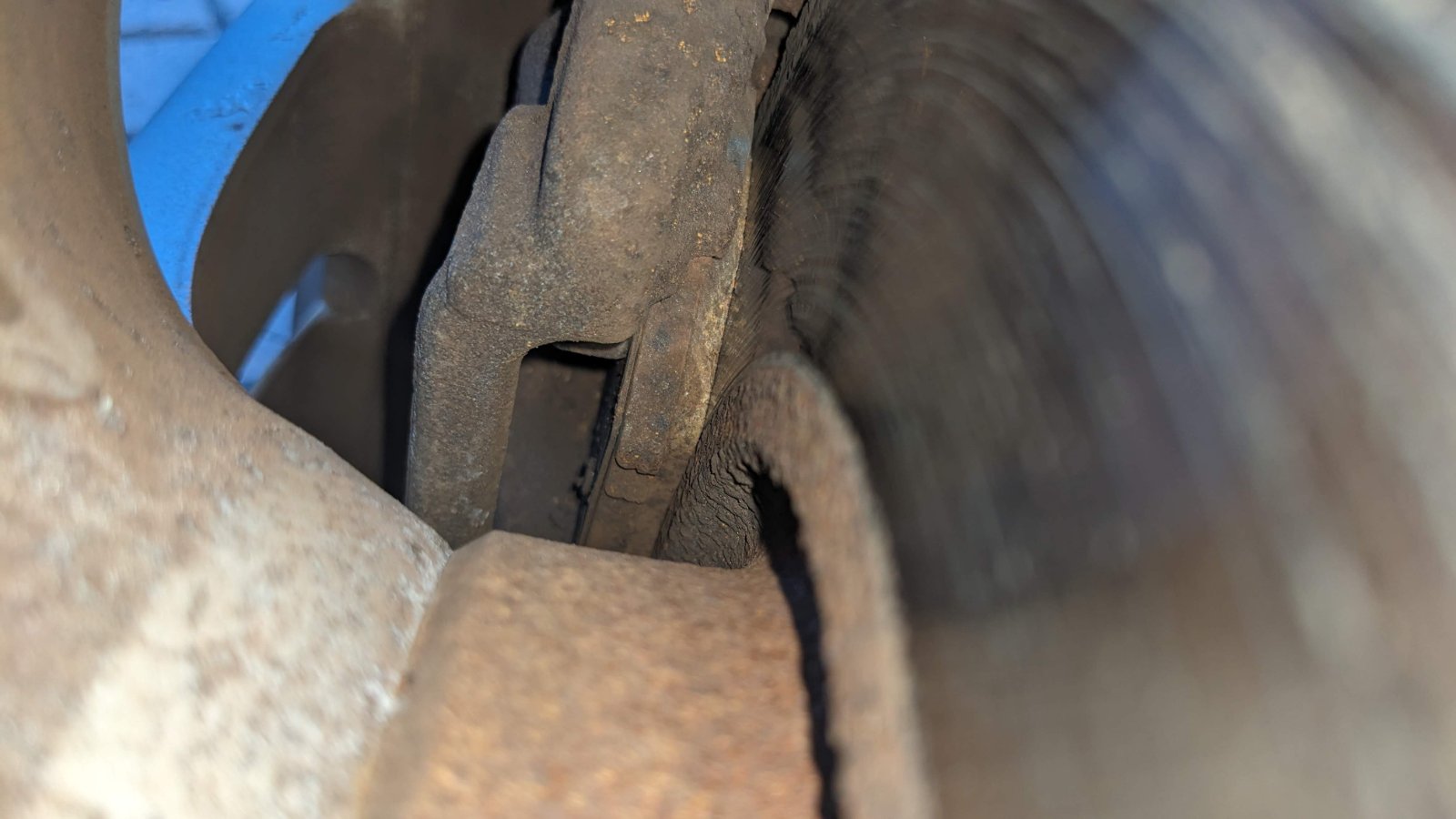

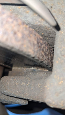

Can anyone help me to identify if those rear brake pads are okay to pass MOT? and do I need to change it in the upcoming month?

They look OK for MOT - limit is 1.5mm. they will need doing in the not distant future however!

I would suggest checking the rotor wear/thickness and do the pad and rotor at the same time if necessary, when the time comes.
