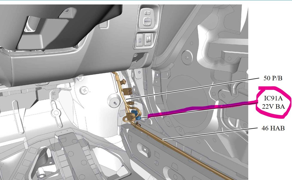

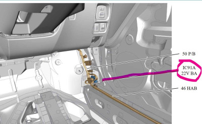

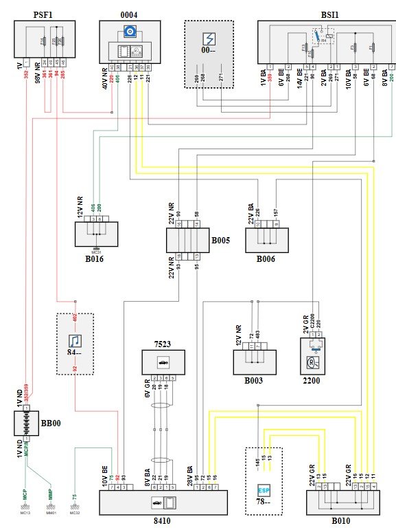

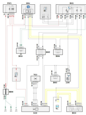

Looks pretty basic. Camera connects direct to head unit. It does go via connector IC91A so that might be worth a look.
Might be worth checking the signal from the reverse light switch at pin 2 of the 28 way white connector on the head unit.

See above post with diagram for possible checks.
