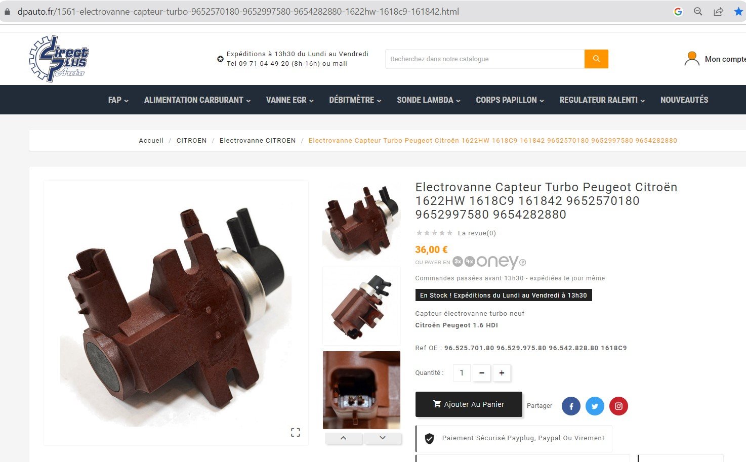

I'm now suspect the turbo vaccum solenoid, which Marc says is only available as a complete kit at £220 (see pic) part 1622HW (ps why did they mount it on the other side of the engine as far away as possible from the Turbo actuators ?)
Ive found a French parts site that suggests that the 1618HW, 1618C9 and 161842 parts numbers are interchangeable.
https://www.dpauto.fr/1561-electrovanne ... 61842.html
Can anyone confirm this ? The parts look the same and as far as I can see, they are all 12 volts and just turn the vacuum on or off.

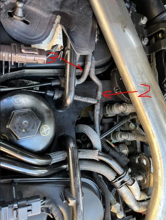

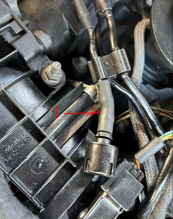

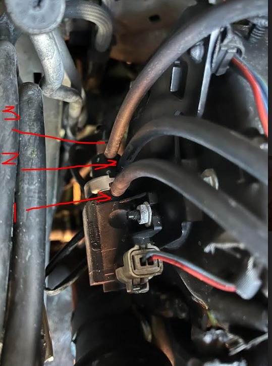

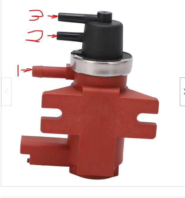

Does anyone have a diagram that shows the correct way the three rubber hoses / pipework connect to the turbo solenoid valve 1618C9 or equivalent eg which pipe goes where ? .
I had a look at mine and traced the pipes as per the pics below
As far as I can tell
Pipe 1 - this pipe has vacuum (when the engine is running) but seems to go into a one way valve (I assume this is preset to open up if the vacuum gets too much) Pipe 2 - this pipe seems to go to both of the turbo actuators via a T joint
Pipe 3 - this pipe comes from the vaccum pump at the rear of the engine (just behind the diesel filter)

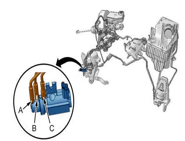

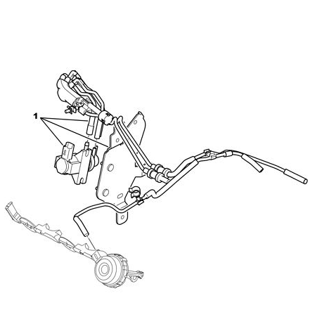

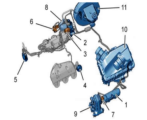

Re: 407 Hdi 2.7 bi turbo issue - valve solenoid
Not sure if this will help:
1) Vacuum reservoir.
(2) vacuum pump.
(3) Rear swirl.
(4) Front swirl.
(5) Solenoid valve.
(6) Rear reaction link rod solenoid valve.
(7) Front reaction link rod solenoid valve.
(8) Rear reaction link rod.
(9) Front reaction link rod.
(10) Air cleaner.
(11) Brake servo.
Assembly
Connections to the solenoid valves :
Sleeves "A" without marking for the vacuum feed pipes
Sleeve "B" with marking (White ) : Actuator controls
Sleeve "C" without marking : breather
(2) vacuum pump.
(3) Rear swirl.
(4) Front swirl.
(5) Solenoid valve.
(10) Air cleaner.
(11) Brake servo.
Assembly
Thanks Marc, as usual
seems mine are okay then as they match the second diagram pipe outs .
I'm trying the track down why the car sometime "loses" power and then is okay. eg limps up a hill at 90 kph but other times is okay at 110 kph / cruise control says faulty and then is okay - This morning I could not rev the engine past 2700 rpm, but after checking the diesel filter (all clean) and doing an oil anf filter change, it was fine and would rev up to 4000.
I suspect I have an electrical gremlin somewhere, as on one diag test diesel temp was -40 C and the next one it was + 50 C.
I've think I can elminate the injectors being an issue (eg all are between 80% and 110% at idle, which is still in spec)
No MIL lights but have a bunch of diag codes which I can't seem to clear (says "clearing code failed") and the car run okay (except for the hills)
May spend tommorrow pulling all the connectors off and checking for corrosion etc
