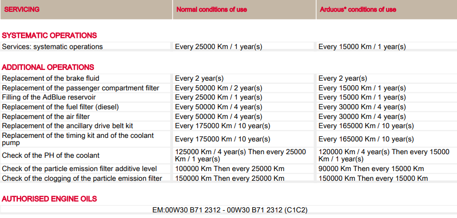

Re: Ds5 2015 service - citroen or general workshop
No problem, it's fine - Citroen's live systems were playing up for a while - it's all working again now!
Ok, so your servicing is Every 25000 Km / 1 year(s)
Click Image to Zoom
Click Image to Zoom
Thank you for this!GiveMeABreak wrote: 09 Aug 2023, 13:32 No problem, it's fine - Citroen's live systems were playing up for a while - it's all working again now!
Click Image to Zoom
