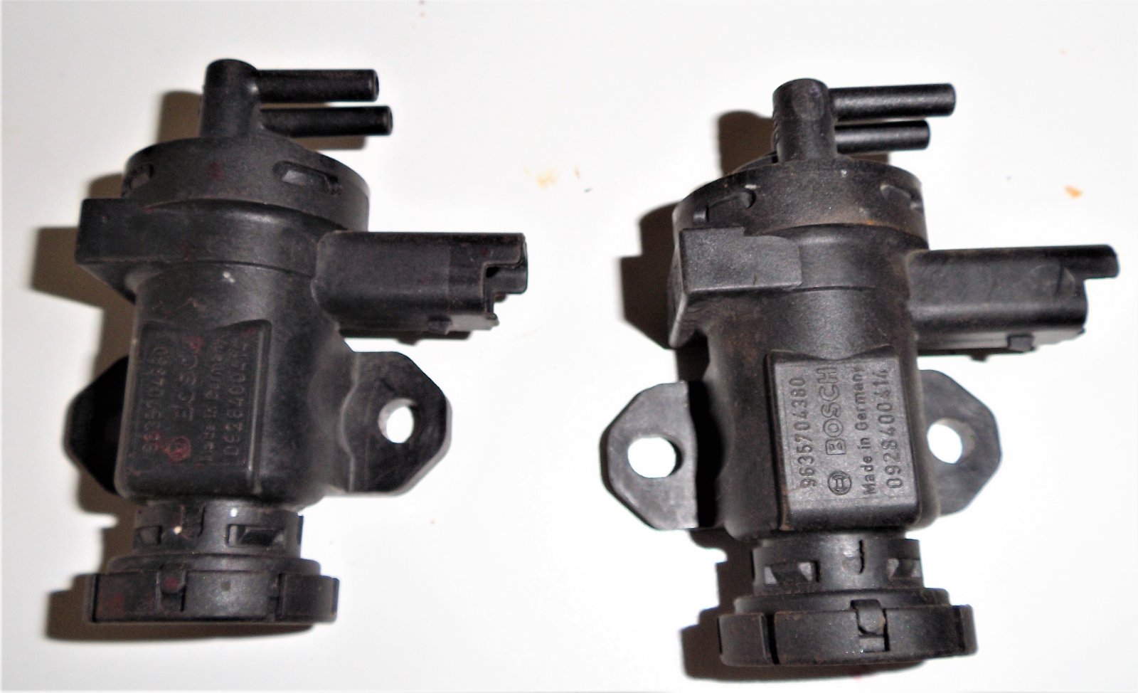

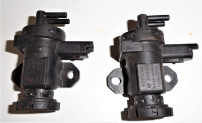

- x 2941
Re: Electro valves...
Poor MAF will certainly mess up the uphill ride, when mine went down had to get into first gear to get up a local hill, when replaced it was good in 4th.
Incidentally I have these sitting on my shelf if anyone wants them.
