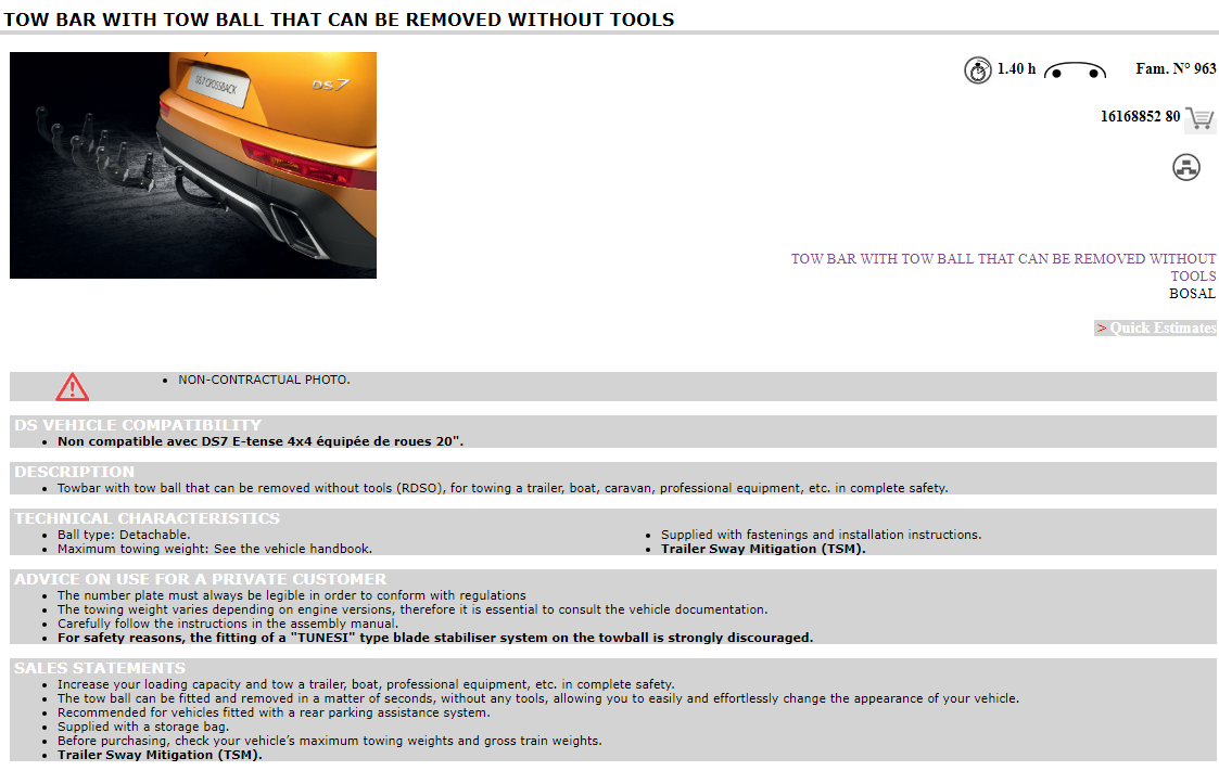

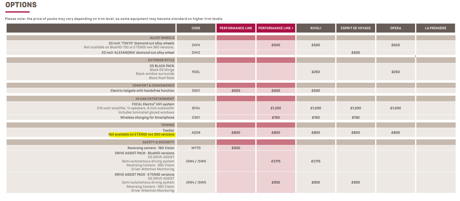

That is correct, now with the additional information you have supplied, DS Autos state:Nhokas wrote: 07 Aug 2023, 16:18 From what i've been told there isn't a single option of towbar for my case.... i don't know why but they tell me that it is not possible to install (not even from factory) a towbar on a e-tense with 20 inch weels.....,
Can anyone confirm this?
If I had your VIN to start with I could of told you that straight away. So there are no compatible towbars in aftersales with DS Automobiles and if you look at the sales brochure, it clearly states that the factory-fit option is NOT COMPATIBLE with this specific engine and trim, so would NOT of been available as a factory fit option at ordering.Non compatible avec DS7 E-tense 4x4 équipée de roues 20".

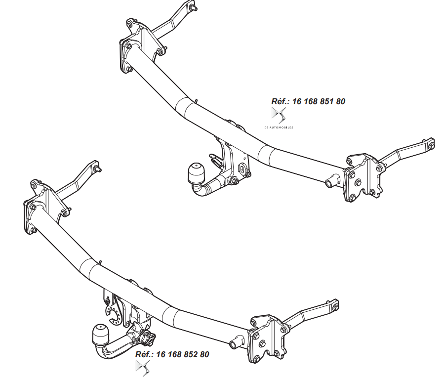

Ok, so back to the towbar issue. I've looked at the only towbar listed for this model and as you can see from the description the same indicated not compatible with the 20" wheels. I suspect (but don't quote me on this), that it may be to do with the sheer size of the wheels and the fitting of the towbar and electrics.
Click Images to Zoom In the fitting instruction sheet, you can see it does list the e-tense
DS7 CROSSBACK; DS7 (X74)
DS7 CROSSBACK E-TENSE; DS7 E-TENSE (X74 PHEV)
So the question is - if you changed the wheels for a smaller size would this then be OK?

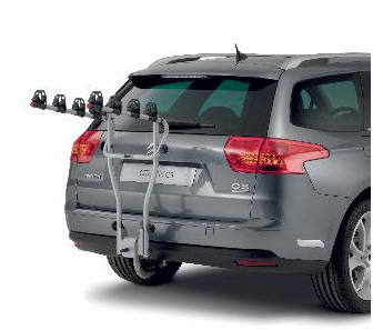

DS then do a 1,2,3 or 4 bike carrier shown here as an example on the C5 X7:

1) Changing Wheels: Possibly - you would have to clarify with DS Autos, as looking at the fitting brochure for both types of Towbar, they do specify they are for the DS7 E-tense, but specifically state not for the E-tense fitted with 20" wheels on the sales page. So that is a question you would have to ask them to check if that's an option to reduce wheel size and then will it be OK to fit the recommended towbar. The dealer has access to French Tech Support -so maybe you can ask them to clarify when you get the recall work done I mentioned - did you see my previous post about this?
2) Yes the Bike supports are options for this vehicle once an appropriate towbar is fitted.
