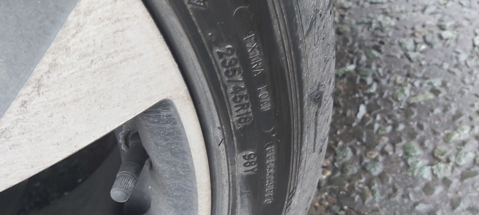

Is it possible to retro fit a space saver spare underneath with carrier,winch etc. My car is fitted with an adblue tank (2015 2ltr hdi blu dsport. VIN VF7**************[VIN obfuscated, can be read by forum staff] ).
Also, my tyre size is 235/45R18 so what size space saver wheel should I buy as the ones on the Internet all seem to be listed as 17inch.

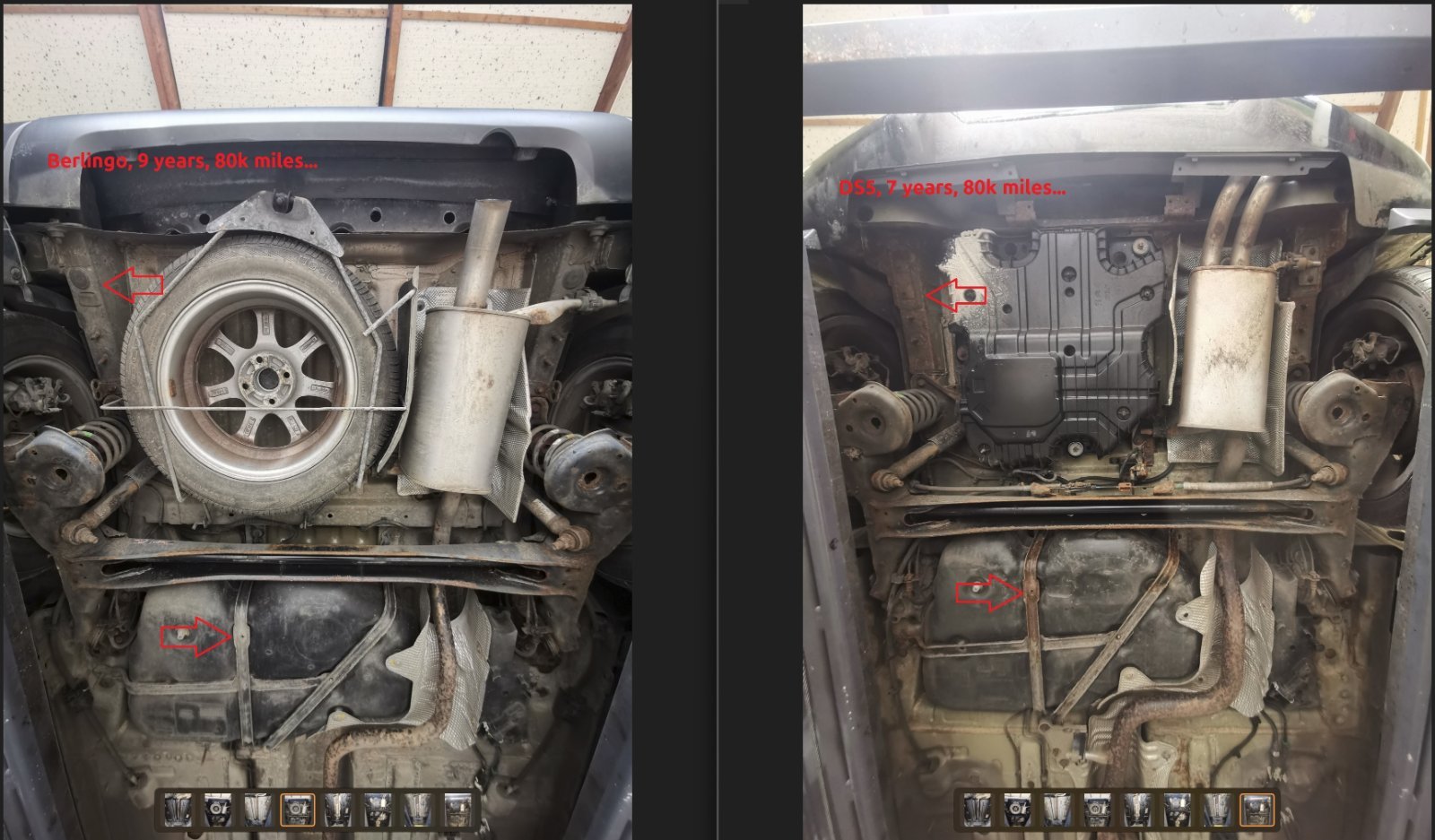

It definitely can't be added with an Ablue tank. Perhaps it could be possible otherwise, even then possibly involving major modification.
The DS5 is based on the same platform as many other Peugeots and Citroens, including the Berlingo. Here's a photo showing the underside of my (non-Adblue) Berlingo and DS5. Besides how incredibly similar they are, you can also see that the Adblue tank on the DS5 is right where the spare wheel is on the Berlingo...
It's difficult to judge depth, but my assessment is that the lowest part of the tank (the bottom left as viewed) is only slightly less low than the spare wheel, using the shock absorber as comparison, so there's definitely no space for a wheel under it. Just look under the back of yours, judge for yourself whether there's space, the answer's no!
By the way, the original purpose of this photo was to show the difference between the older Berlingo that's mostly lived on the south coast, and the newer DS5 that's mostly lived in Scotland but is rustier. Both have now been smothered in Waxoyl so hopefully preserved for a bit longer.

One last question if anyone can advise re a space saver wheel, can I use a 17inch space saver while my standard wheels are 18inch (235/45R18)?
