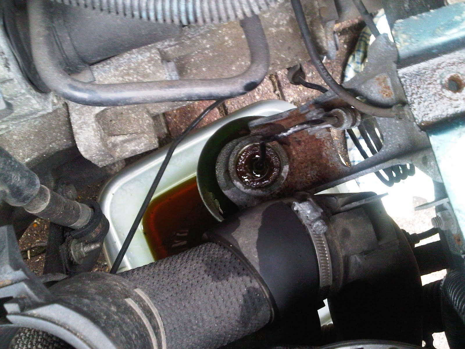

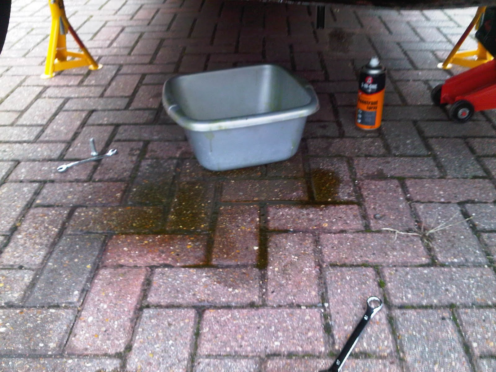

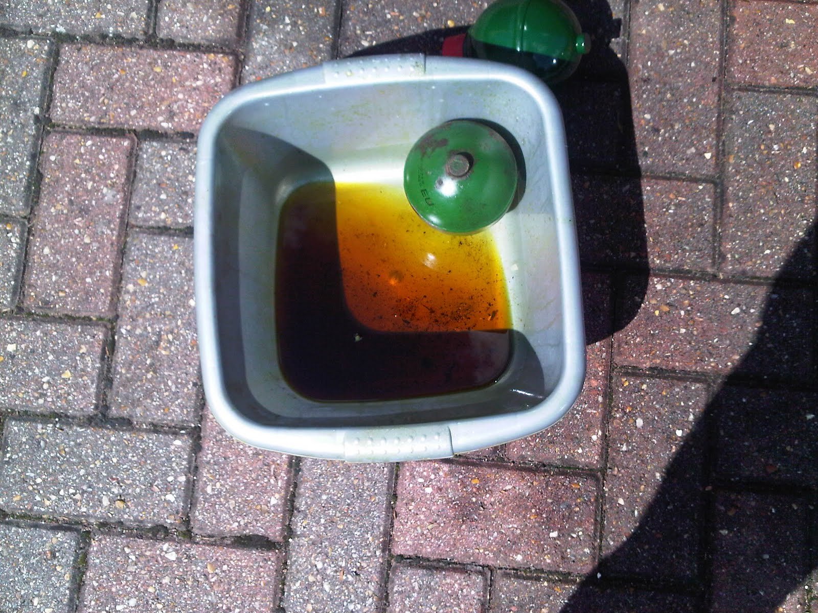

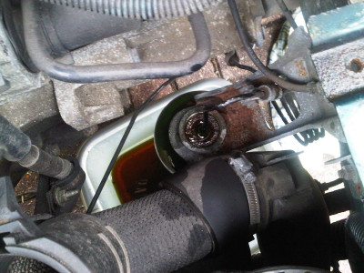

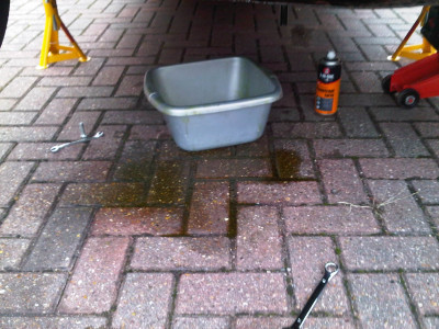

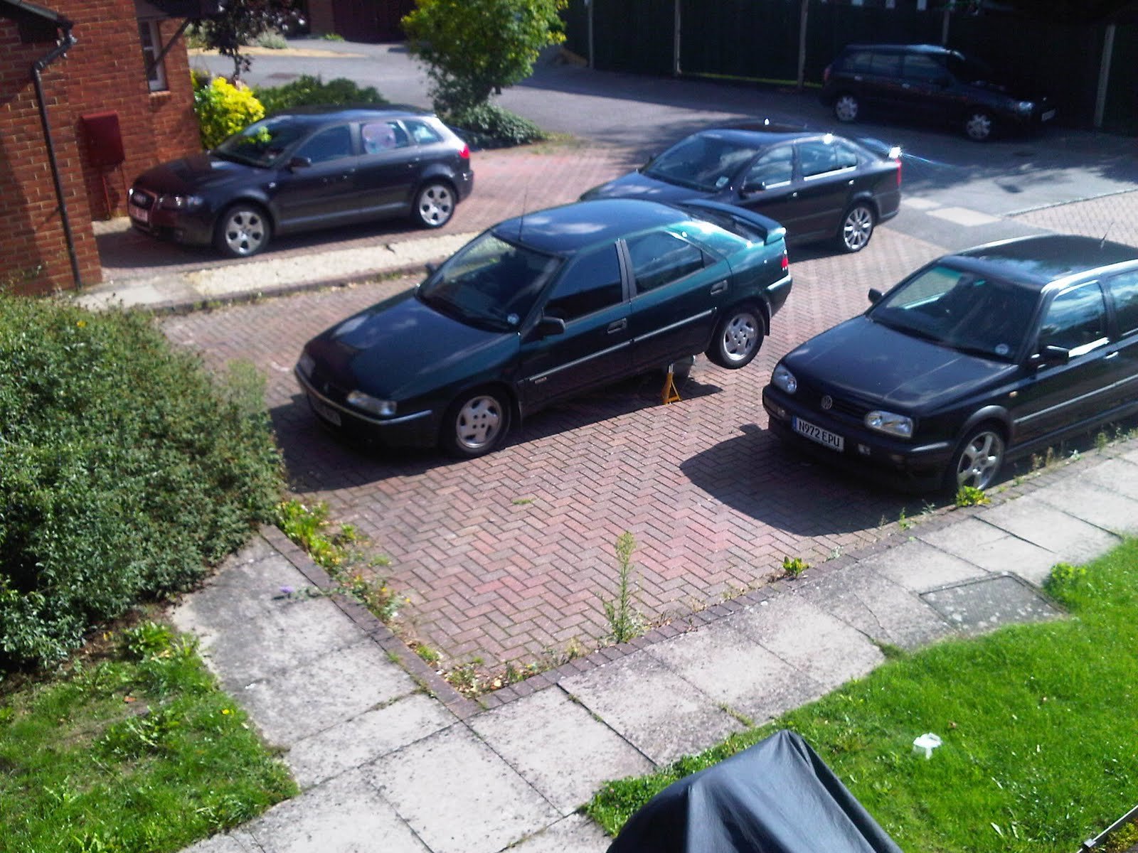

Firstly, make sure your car is supported on stands. On your shared drive between your neighbour's cars should be ok.
Next, ensure you have a bowl to catch any tiny LHM drips in. Your significant other's favourite bowl, perhaps? Place it in the wrong place initially, to make you really unpopular with the neighbours, unless yours like LHM on the shared drive, of course. Spray penetrating fluid liberally all over every thing you may have to undo. Ensure to get a bit in your eyes, for full effect.

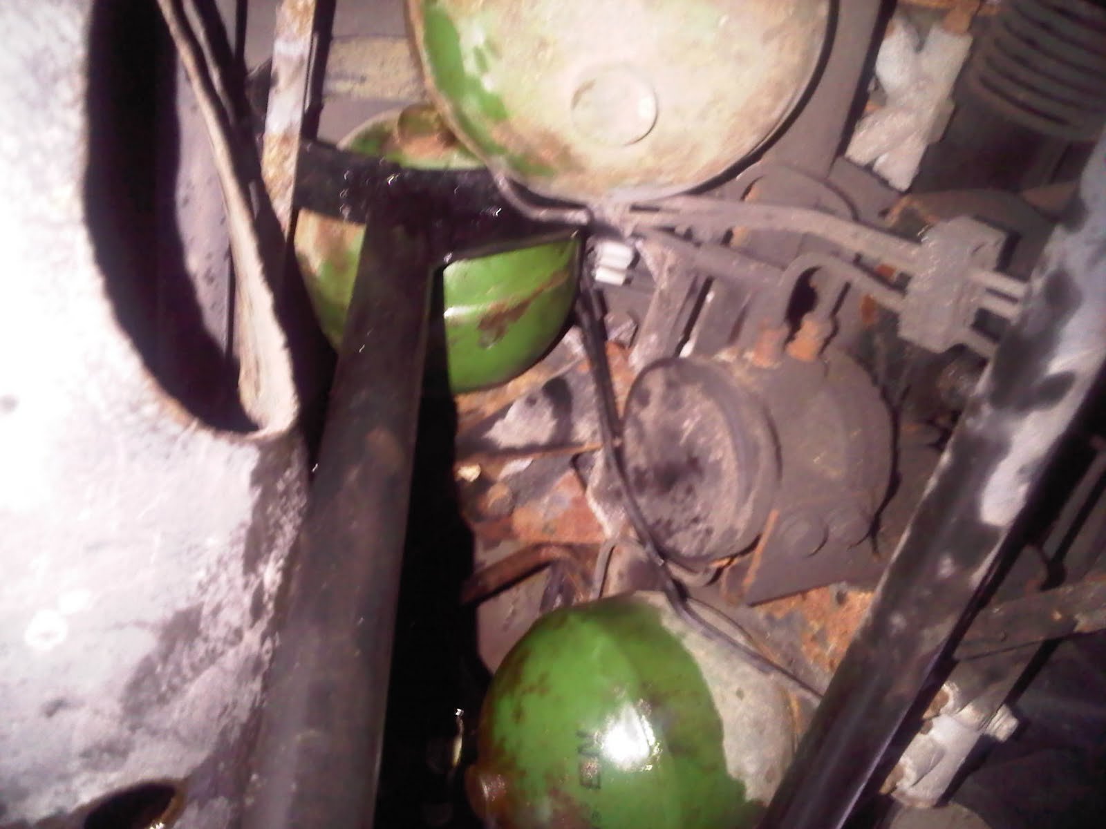

Lie on your back. Ensure your mouth is open to catch bits of falling rusty crap. You'll see something like this..
Be quite violent with the sphere tool, but careful at the same time as this particular sphere is mounted on a bracket which can bend. Pause every minute or so to have a good swearing session, as it is hard to put enough effort into undoing the sphere AND swear at the same time.
The next step is to move the bowl again, to ensure that the jet of escaping LHM goes all over your head and face, rather than in the bowl.
Once this sphere (and seal) has been changed, you can move on to the rest. I seem to recall this particular sphere (front Activa sphere?) being "fun" to do also.
You will then be left with some green balls, and a bowl with some extremely dodgy looking fluid in it...
Repeat the procedure for the other 6 spheres, whilst wondering why the f#$k you bought an Activa in the first place.
I hope this guide helps :-P
