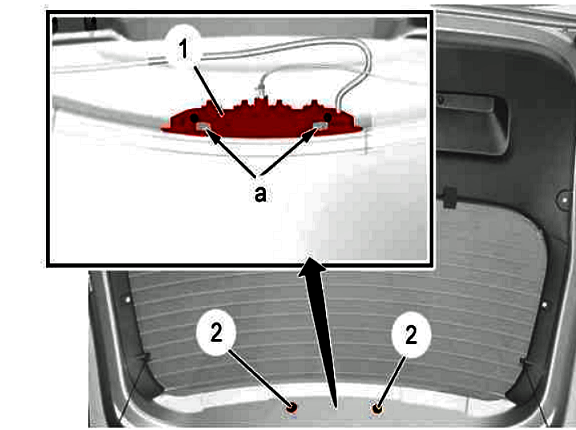

You need to open the tailgate and on the INSIDE there are 2 caps / shields to be removed to expose the brake light clips that need to be carefully released:
Use trim removal tools to carefully detach the brake light, which will expose the electrical connection and the rear washer piping.

Re: DS 3 Rear Washer Jet
Hi. Thanks for the response,
I have taken the caps off but it's not immediately oblivious how to release the clips inside the trim. The aperture is too small to see what one is doing and I don't want to Force the trim off
I just did this on my recently bought DS3, I used a small screwdrivers and gently probed about until I found the clip, and pushed until I could manipulate the light assembly out. Then disconnected the wiring and hose, then blew the nozzle both ways. Now works ok, but I think i opned th ehole a litle when messing about with a needle a few weeks ago!
Hope this helps.
