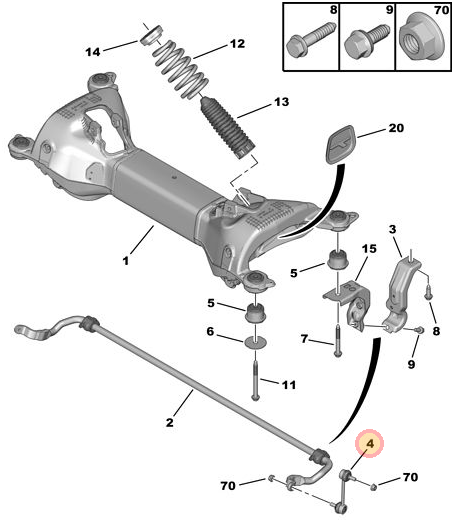

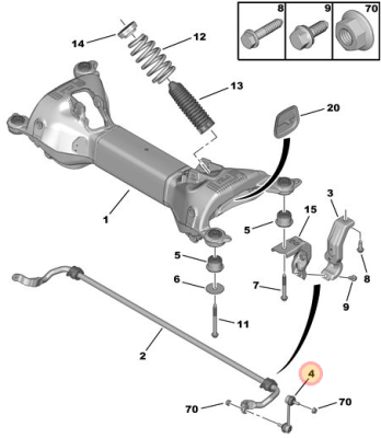

The rear ARB drop links (4) are only £74 inc. VAT for the part (4)...

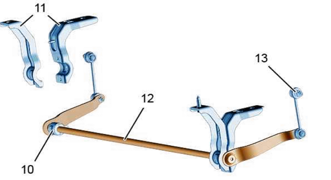

..., but if it's the ARB bearings (10) on the second diagram, they are not replaceable and it will need a new ARB.
I don't have a time (labour) for this job alone - so you'd need to call a dealer for a quote to replace.
