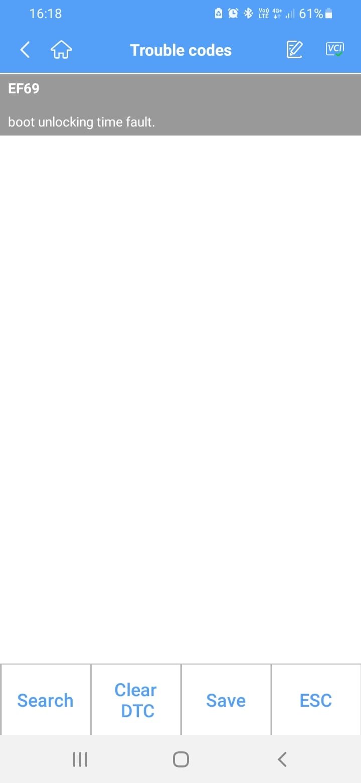

So, all I can really deduce is that a roof position switch is halting the lowering of the roof any further. The message that the Autel gave on diagnostics is attached. Error EF69 "Boot unlocking time fault". How would I identify where to begin looking for where the problem lies?

I can't provide any help on this, sorry. The fault data on these early models is very non-descript, The official EF69 code simply states: "Boot unlocking time fault: High stop" and that's it! I see you have also posted on one of the Peugeot Forums - so hopefully you'll get some assistance from somebody.

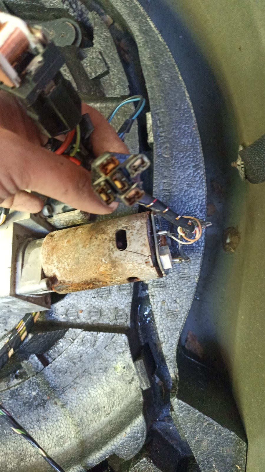

Hello, I have solved the EF69 problem. It is the hydraulic pump, in my case the circuits oxided. To do this, I cleaned the contacts (relays), removed the pump motor and re-soldered the components, and before installing, I tested the pump motor outside the car by connecting it directly to 12 volts. After that, I armed the system, deleted the error code with Diagbox and it worked normally again. I hope to be helpful. Greetings

maybe it will be useful to someone, today I solved the problem in the following way.. I added liquid to the roof pump through the valve on the tank, but most importantly, the problem completely disappeared when I turned the pump 180 degrees, using the valve for topping up, which is on the body , down so the liquid began to be pumped into the system
