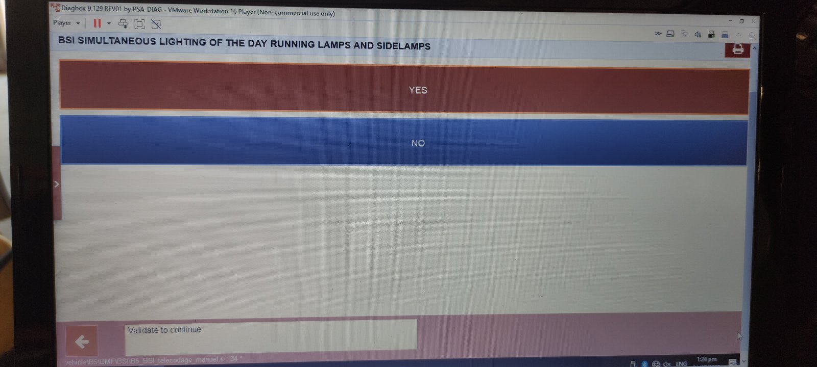

In the menu I don't have an option like the one shown:
The setting: "Simultaneous lighting of the daytime running lamps and sidelamps" - YES or NO.
That's it, you can't choose what types of daytime running lights to be.

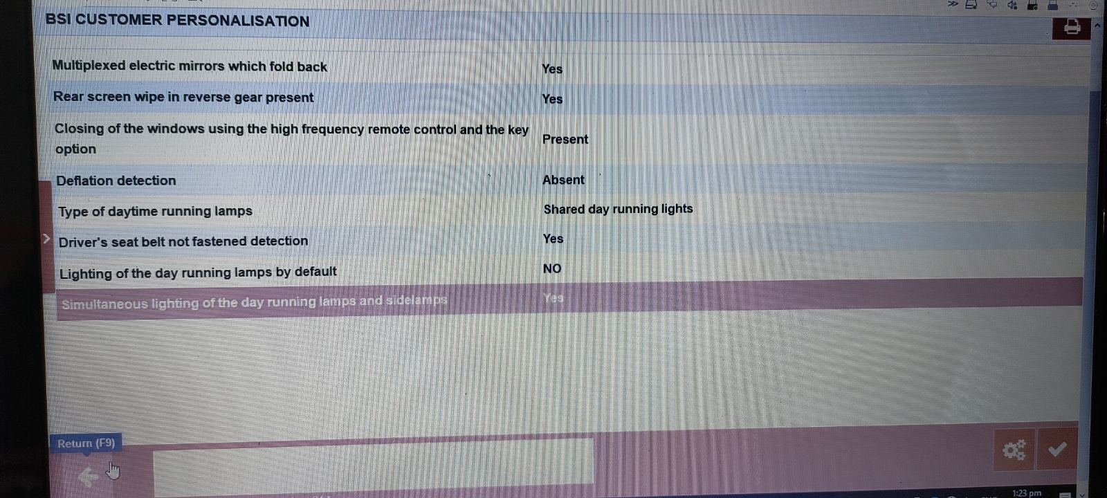

Diagbox/Lexia
Diagbox/Lexia
Diagbox/Lexia - C4 GP
x 6957
Re: Citroen C4 Grand Picasso Exterior Lights
The option ""Shared daytime lamps" for the Nordic countries: Lighting of dipped beams + front sidelamps + rear lamps" is the Nordic option I mentioned which you have that set to. But you CANNOT set the Dedicated DRLs as an option if you do not have them fitted as in 1) of your first post.

I have set it to dedicated DRL and set to additionally automatically turn on the headlights.
Now everytime I start the engine the headlights turn on, which is what I wanted. Regardless of the headlight switch position. Well except on stationary lights position, but that is it.
If you need I can check with diagbox exactly what I did.
