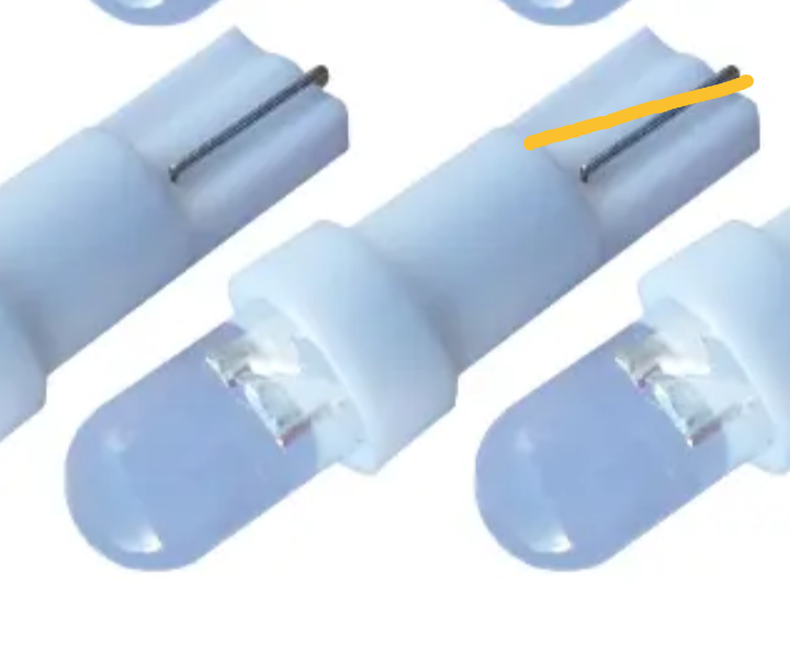

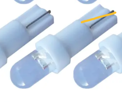

Re: CITROEN AX CLUSTER BULB CONVERT TO LED?
It's possible for the wire to get misaligned like this:
And so misses the terminal in the bulb holder completely.
As others have said, they only work one way round.
Other to note: very directional, light predominantly shines straight out the end. Bulbs omnidirectional and it's not unusual for the light emitted sideways that generates the illumination intended by original (instrument cluster) designer
