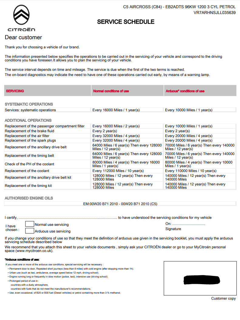

Re: Help, I need picture of Citroen dash
Ok, so in your case it is stated as 16k miles or yearly on the schedule for normal conditions:
Click Image to Zoom
Click Image to Zoom

I think the 'gotcha' here is the xxx miles or '1 year'. mY servicing is 20k miles or 1 year - so I've effectively had 3 services in just over 20k miles!

That issue means they are required to check the condition of the timing belt at each service and replace it if necessary, which as you can see from the schedule is why the initial timing belt change is set at 65k miles, then when they have replaced with a new belt (possibly a later design) , they put it back to every 128k miles / 12 years.
As for the servicing, unless you have anything in writing confirming the 18 months, then they've got you there it seems.
