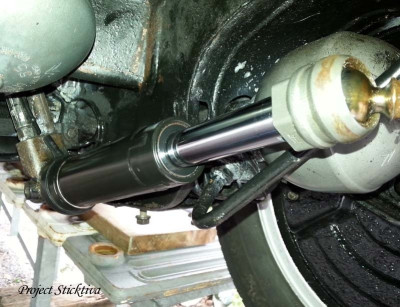

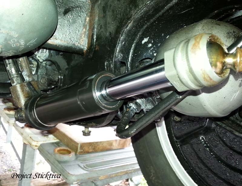

The front and rear roll control rams are fine - except for the dust covers. Both are disintegrating and the front one is completely shredded. New ones do not seem to be available - can anyone help, either with a possible supplier anywhere in Europe, or suggest a suitable alternative which can perhaps be adapted? Thanks in advance

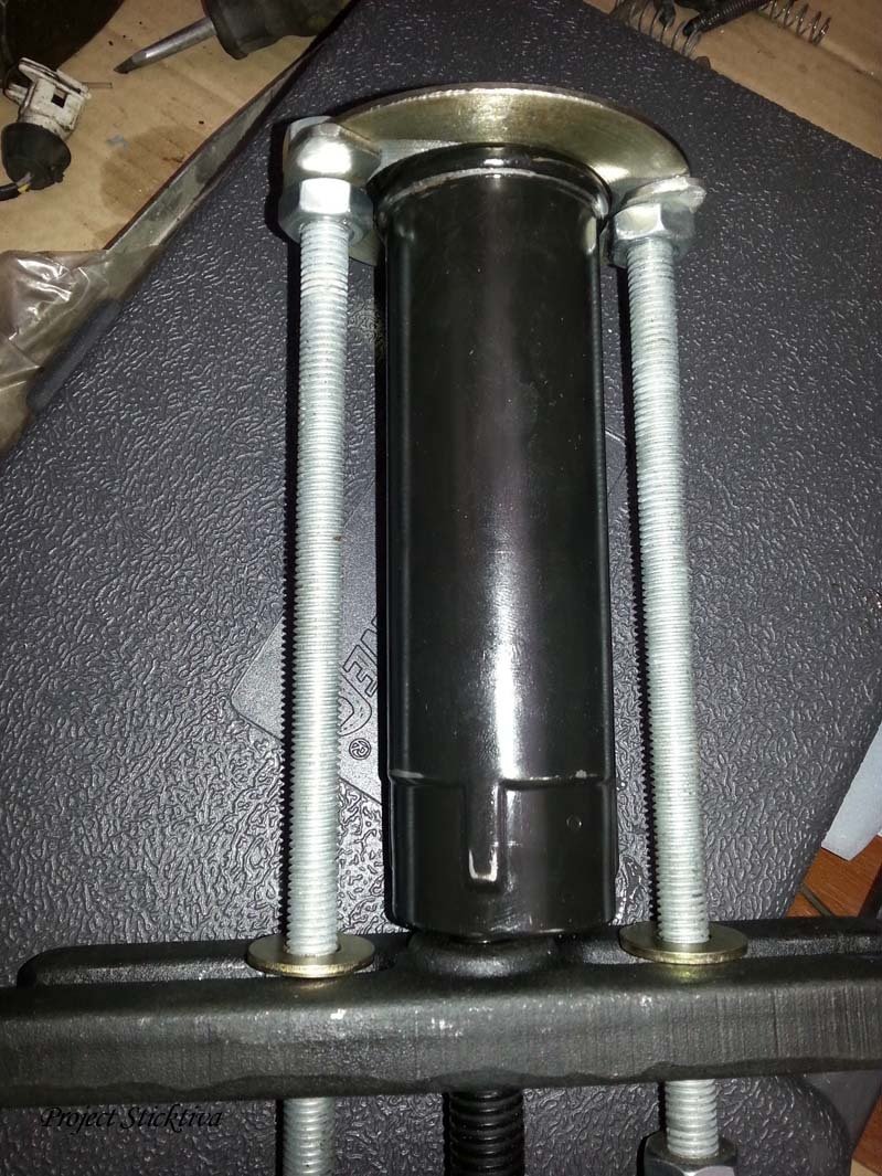

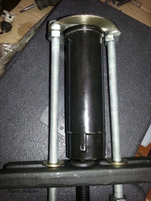

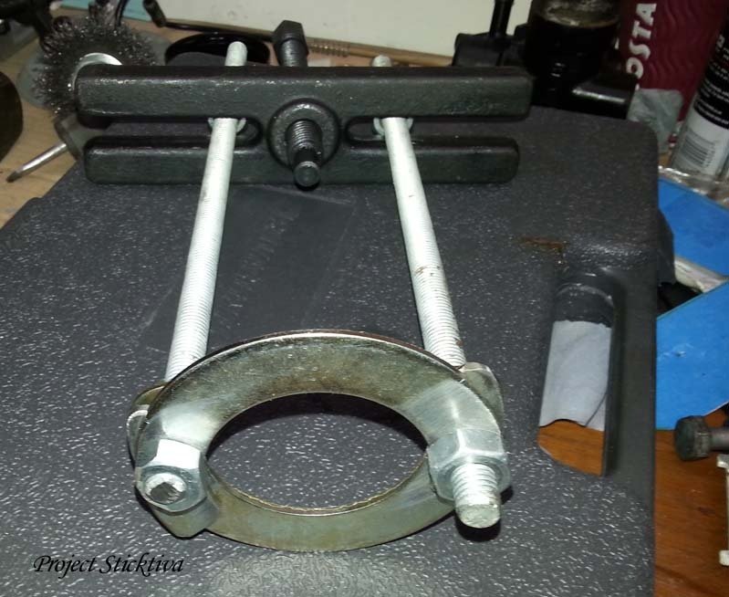

Be warned, you will (90% chance) have to replace at least the lower bush.....(Berlingo steering ram bushes are the same) Also, take great care not to damage the top mount, that is much harder to replace (as are the feed pipes)
a little tool I made for the job (under Jim's guidance)
viewtopic.php?t=50854&start=255
