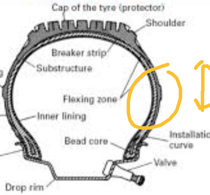

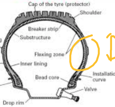

Dropping down a size can add a cushioning effect on the ride as the tyre wall is bigger so more air to cushion the pot hole impacts. When it comes to speed, is it measured against the tyre or is it rotational speed of the driveshafts? If it's done by shaft speed 30mph is 30mph regardless of tyre/wheel size. There are discrepancys, is that why the police give us 10% leeway on speed?

Agree on tyres, more sidewall = more comfy.Rp0thejester wrote: 28 Jul 2023, 21:18 Dropping down a size can add a cushioning effect on the ride as the tyre wall is bigger so more air to cushion the pot hole impacts. When it comes to speed, is it measured against the tyre or is it rotational speed of the driveshafts? If it's done by shaft speed 30mph is 30mph regardless of tyre/wheel size. There are discrepancys, is that why the police give us 10% leeway on speed?
Unfortunately you've got in a muddle on the speedometer front - if you think about it, a speedometer really is just like an rpm gauge in its function - it measures the driveshaft/wheel rotational speed, only the scale you read has a conversion where this is effectively a bit of multiplication:
Wheel rotational speed (I e. Revolutions per minute) X wheel circumference (I.e. distance per rotation) = distance per minute. Obviously can then convert from that to miles per hour by multiplying by 60.
This is only true (or rather the Speedo is only correct) when the wheel circumference is as designed. On the hypothetical mini swapped onto 21" rims, the Speedo will still be set up as though each revolution moved the car forward the circumference of a 10" wheel. But it would move a much greater distance per revolution= faster for any given rotational speed
Hope that makes sense!
The other thing not talked about with more tyre sidewall Vs more inches of alloy wheel (i.e. keeping the same diameter of wheel overall) is that the car will accelerate slower with low profile tyres on big rims! This is because the sidewall weighs very little - certainly easily less than a cast aluminium wheel rim an inch bigger: And rotating masses have a greater impact than just dead weight (so the 10" wheel mini with the 21" wheels in the boot would be faster than wearing the 21" inch wheels and carrying the 19" ones in the boot instead! Obviously this daft example also ignores the terrible effective gear ratios the huge wheels would create, so the mini more likely to explode it's clutch than get any meaningful 0-60 times!
