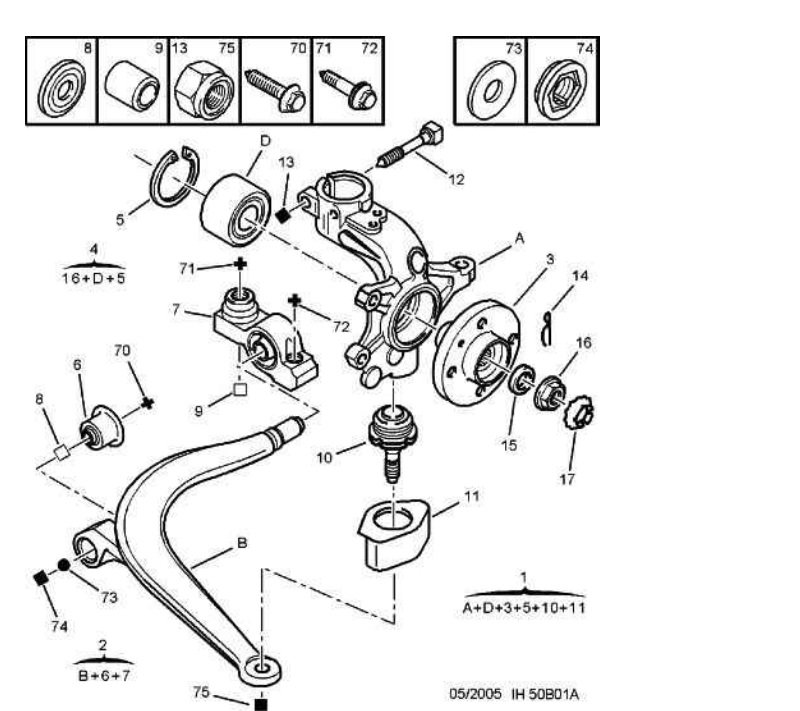

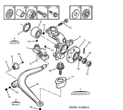

Unfortunately, between me and the mechanic, I've lost both the "buffer joints", which form end caps on one end of the front bushes. They are part 8 in the following diagram (see top LH box for picture):
It seems to me that without this part (essentially a thick, rubber covered washer) I will have metal to metal contact and significantly increased wear to the bracket that the front bush is bolted into.

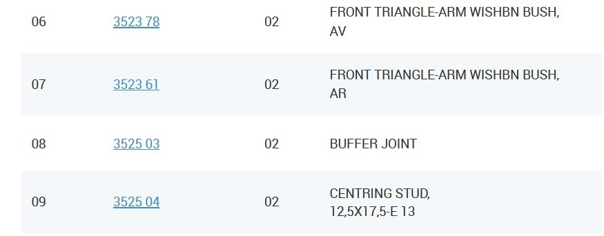

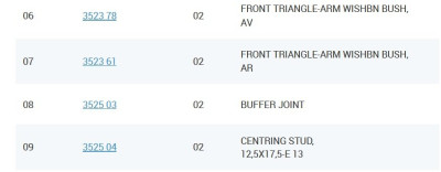

In this small sample of part numbers you will see the buffer joints have OEM part # 352503 This part is marked NFP by PSA/Stellantis, and I have not been able to find any supply from either Australian or overseas suppliers (not even from peugeotcitroendsparts.com). I would be perfectly happy with 2nd hand parts - but I can understand that no-one would want to separate them from an LCA that was at all useable.
I have not yet tried local motor factors (we just call them auto spares shops) to see if they carry anything of similar size and construction not listed for a Peugeot 406.
Interestingly, the arm (Part 2) is sold as a combination of metal arm (labelled 'B'), plus the bushes (labelled 6 & 7). Apparently the buffer joint (#8) and the centreing stud (#9), are not regarded as essential parts of the arm, and yet they both seem vital to the proper installation and operation of the LCA. In some photos of aftermarket LCAs this buffer seems to be present, but I'm not yet desperate enough to order a pair of new LCAs.

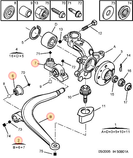

(8) Is a flexible mounting stop. It's the other side to (6) the flexible wishbone arm mounting. (8) goes into the other side to fix it and help keep out any crud before the nut, washer and bolt are put on to keep it together. I suspect without it there will be movement and you will soon get debris inside and the bush will perish much sooner.
You may still be able to get the complete wishbone complete with the bushes. But there are several types, so I'll need your VIN (please post your VIN in full without spaces - it will be automatically masked from public view after submitting your post & will only be visible to staff).

Ok, so if it's the right side wishbone, then this includes B, 6 & 7, and is still available, part: 3521E1, £292.26

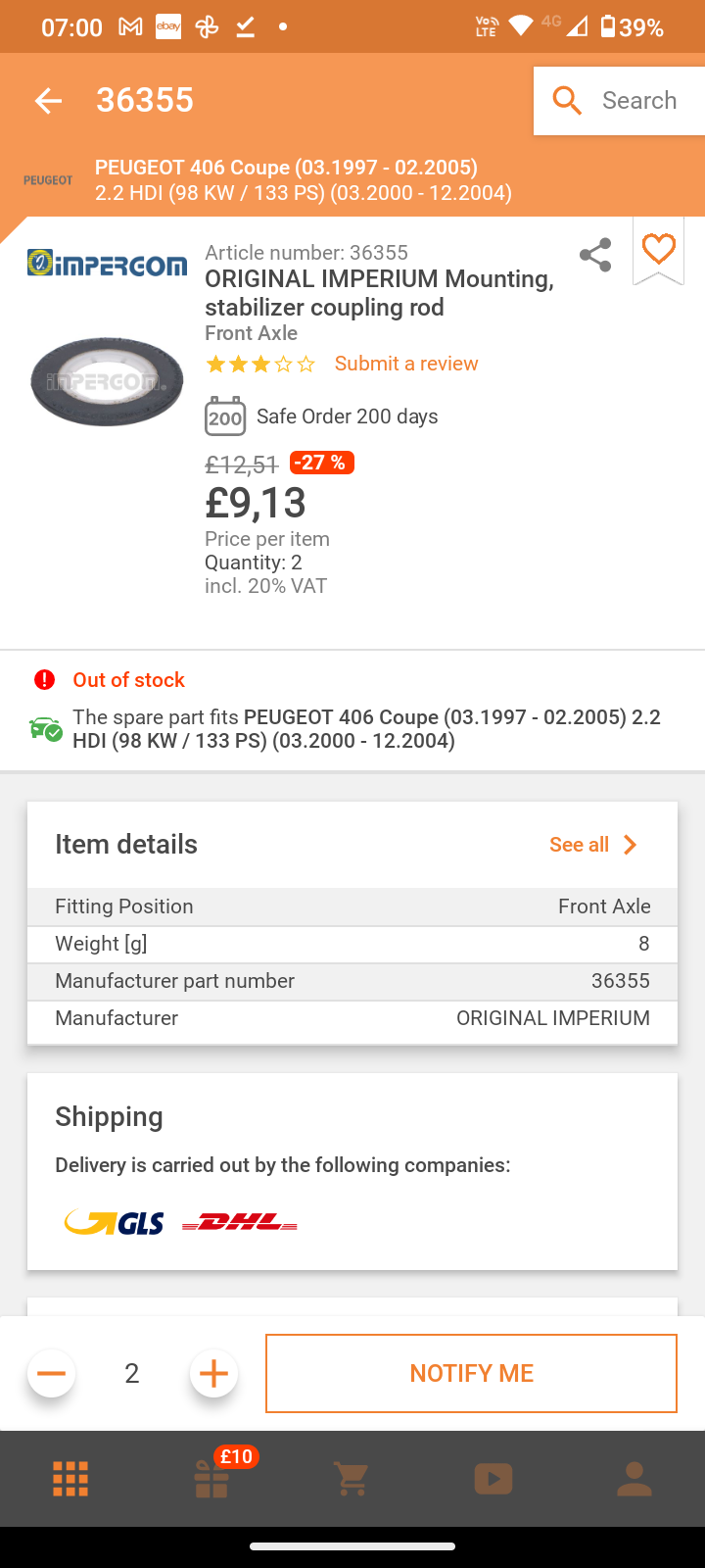

Autodoc list them, though out of stock
https://m.autodoc.co.uk/original-imperium/9644394

P.s. ignore the number at top of that page (presumably an Autodoc catalogue number??) I searched for 352503 and this is what came up.
Searching eBay for the same number just gives anti roll bar bushes for an IVECO !

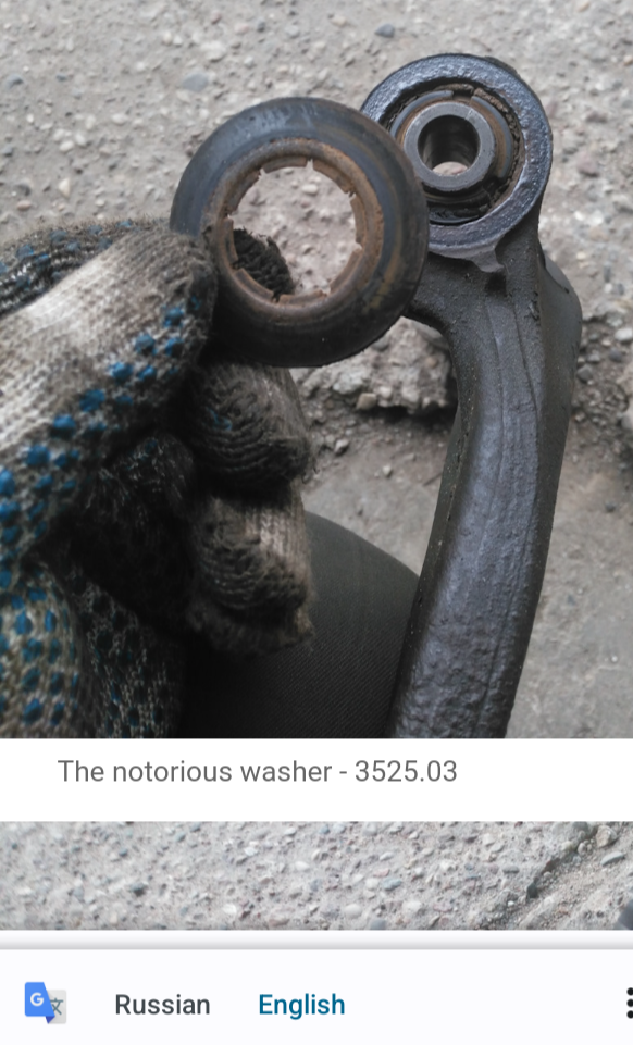

Thanks - appreciate the effort. Also thanks for the Russian photo - my memory of what they look like was getting hazy, and the sketch on the parts diagram is poor. Why is it "notorious" - because it's important but made from pure unobtanium?MattBLancs wrote: 18 Jul 2023, 08:45 Widened the Autodoc search, see if any other suitable options.

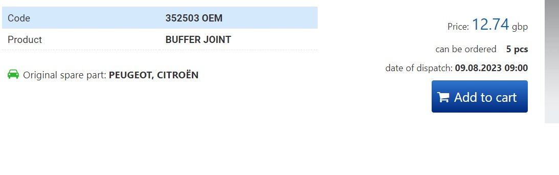

Alvadi may be able to get them (for a price). They list the same thing twice despite not listing a manufacturer:
"Original spare part, BUFFER JOINT, 352503 OEM The other listing costs slightly more, and is expected to ship one day later. Does "Can be ordered 5 pcs" mean they can only be ordered in packs of 5, and if so is the price for one or 5? This did happen with some bungs I bought from peugeotcitroendsparts.com - price listed was for one bung, but they were only sold in packs of 5.
Could anyone offer an opinion on whether Alvadi's listing is likely to be "for real" - since
a) they don't have them in stock (else why the 3 week delay in shipment) and they are supposedly genuine OEM parts
b) My local Peugeot/Citroen dealer replied "No longer available ex-France" (& I think Marc would have corrected me if Service Box still listed them)
My assumption is that they used to be able to get them, and haven't updated the website...

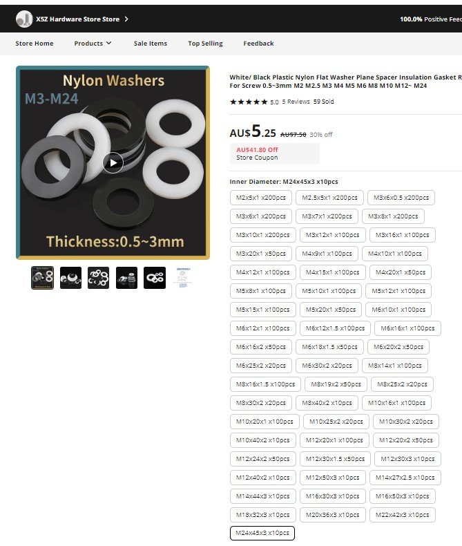

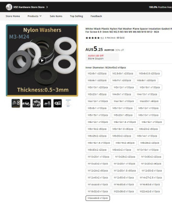

if you have rough dimensions, you can get big nylon washers on Aliexpress
M24 hole is AUD $5.25 for 10 of them
