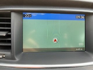

Hey.
After I have update my map, I got a screen who is green and show the level over see.
I't ask for Installations CD, I have installed the cd whit out any changes.
Hope someone can help:-)
Best regard .
Navigation RNEG2,86

I had this problem seven years ago in my X7. The head unit was replaced, fortunately under warranty so at no cost to me.
As your problem appeared after a map update (mine wasn't, it just happened one day) I would suggest you update the maps again.

I have now try to update all maps and running the installations cd whit out no changes.
Disconnect the battery and connect it again, no changes.
My questions is now, can it be the micro sdcard, or should I go to the workshop?

That's a hardware issue and installation of the maps won't make any difference. It's likely the graphics chip is dying, so time to start looking for a replacement / repair.
If you go to Peugeot, they will charge you the equivalent of £120 for a diagnostic. They will be able to run some tests that may confirm the hardware fault.
