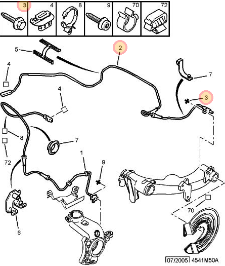

The ABS sensor has been working fine, so I do not plan to change it. It is also stuck, the ABS holder's bolt head has corroded to a 7,5 mm near round bolt, and it seems tempting to let it stay when I try to remove the bearing. (According to the parts diagram, it is/was a 6x100 mm screw, with an 18 mm base)

All I can tell you is that the ABS sensors are extremely sensitive and must be kept away from other metallic objects and not knocked or dropped to give you some idea - according to Citroen.
(2) Rear ABS Sensor, part: 4545A5 (no longer available from Citroen).
(3) Flanged Bolt (DIAM 6X100-18), part: 030713 (Still available from Citroen).

Thanks a lot. It's great with such fast and enlightening answers. The stubborn screw is # 3 in the drawing...
