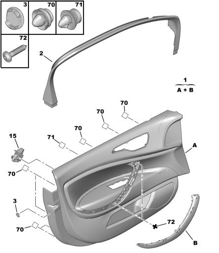

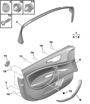

It's just a trim piece, but they have very thin mouldings that can snap:
If it's the piece above, then here's a photo that may give you a little idea of what's on the inside - as you can see a non conforming multitude of fixings!

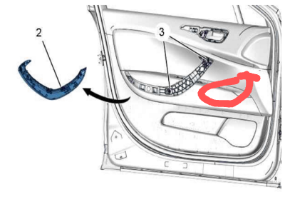

I got that bit off its the bit in the bit further in I was on about the bit circled it runs the length of the door card. I am not sure what mine is called its a black hard wearing coarse cloth material not velour it's a bit like a kind of moleskin or canvas, if you know what I mean.Trimmed with silver.
I can't get a spec sheet for my car.
- Attachments
Darren
- x 6955

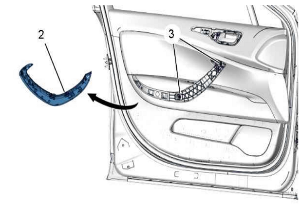

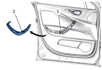

Re: Sticky interior trim
That's part of the door card trim and doesn't come off as far as I can see - except as part of the door card Darren.
