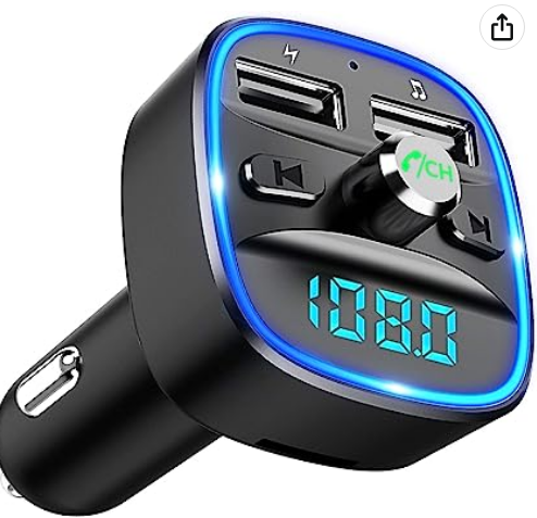

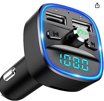

If it's just Bluetooth audio you want consider something like this for £15 - does bluetooth streaming, calls and plays music from USB....
https://www.amazon.co.uk/Syncwire-Bluet ... hdGY&psc=1
If you want to replace it for an RT6 (make sure you have a compatible hardware unit), it will involve replacing the screen also as RT6 requires the Hi Res display, plus telecoding.
