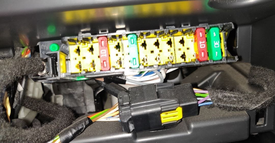

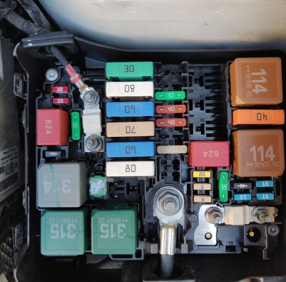

1)About fuse i'm not able to understand which is the one to check, in attached the images of my fuses.

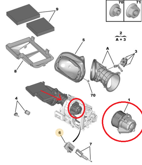

2)I not listen noise coming from the fan so in my opinion is not broken the plastic or the noise of running motor should be listen. Btw i'm trying to have a camera to go inside though filters and check the status. Scheme in attached.
3)if the motor is broken i would like to check plug with a tester but not able to understand where is located.

If the motor fan works on ANY speed then it won't be the fuse.
It's more likely to be the Blower Motor Control Module (6) on the diagram.

The blower motor won't work without the blower motor control module. These commonly fail. Sometimes it means the fan is on full speed and sometimes nothing at all.

Ok, so what happens it that moisture gets into the bearings and causes them to seize up. The blower motor control unit is the resistor and is designed to power up the fan SLOWLY first of all and then gradually increase the speed to what you have selected. When the bearings get seized, there isn't enough power supplied by the variable resistor to start the motor off from standstill, so this is why it wont work.
What you have done is temporary, by helping it start off. But this will happen again over time, so be advised, but at least you have it working again for now.
