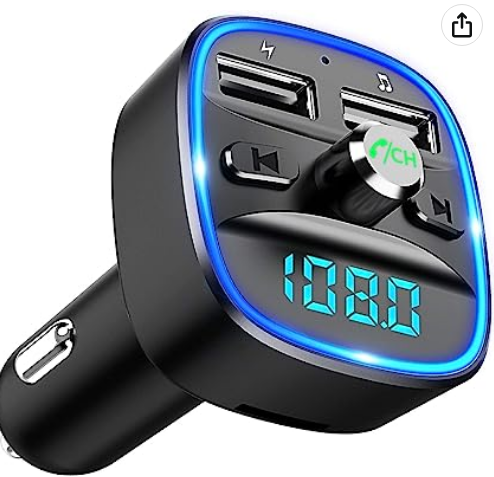

There are several options to consider.
Leave the original head unit in place and get a gizmo for bluetooth streaming. There are several options you might want to look at, here's one example for £15 that might be worth a punt - seems you can stream music via phone or USB stick and supports hands free calling.
A bluetooth transmitter that plugs into the 12V socket and uses a radio frequency to play through the vehicle's speakers:

I used one of these in my old C5 (mk1). Great bit of kit does the job perfectly. If I remember right though, for best results you need to use the lower fm bands as they are not so busy. 87/88mhz.GiveMeABreak wrote: 09 Jul 2023, 12:44 There are several options to consider.
There are also stand alone sat navs now that have the same feature and will hold your music library.

Cheers guys! I’ve had one of these radio transmitters before I swapped the stereo out but my 12v port is a bit shoddy from the kids sticking 1p coins in them. I’ll buy another and clean out the ports. Thanks again
- x 6950
Re: After market stereo suddenly not working
You can replace the 12V socket easily enough. Citroen sell these separately, so easy to sort, then all you have to do is sell the kids
