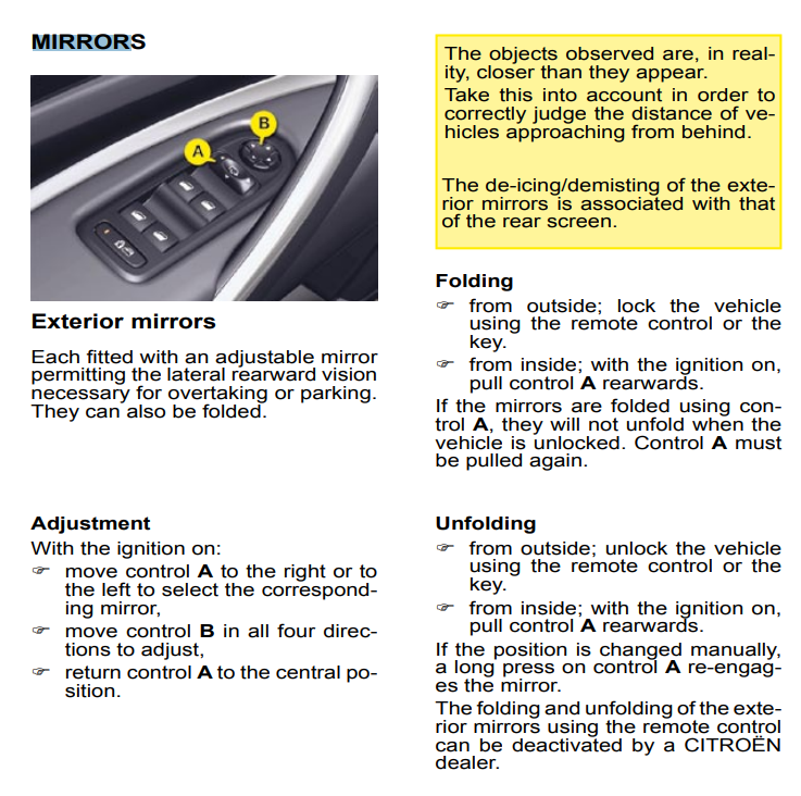

It can be deactivated from the fob via Diagbox, but here's an extract from the manual that can prevent automatic folding and unfolding:

Re: Drivers side folding mirror issue
So if I understood it right if you lock the car so that mirrors fold and then unfold the mirrors via control switch they will stay unfolded? Until you reengage them with the control switch again.
