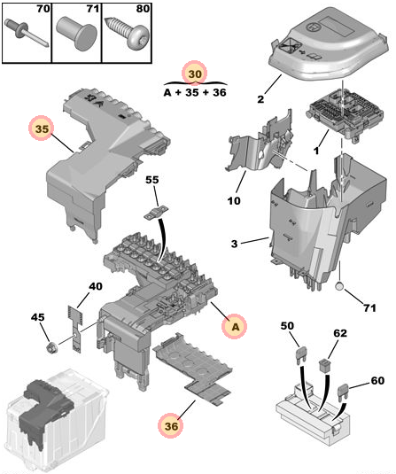

Supplies protection and management unit: Central power switch positive (+CPC) relay status fault: Relay closed. So there would certainly seem to be an issue there...
Protection & Management Unit, part: 9665878080, £353.84.
Note these need configuring when replaced similarly to the BSI, and will need online access to do as it's a 2016 vehicle. So may be better to get the dealer to diagnose for certainty, fit and code as they are unlikely to code a second hand unit for insurance liability purposes if anything goes toes up with a non-dealer sourced electronics part.
