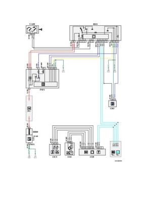

I am trying to find a wiring diagram for the additive tank pump, and where in the BSI it connect but, I can only find wiring diagram for the 2013 model.

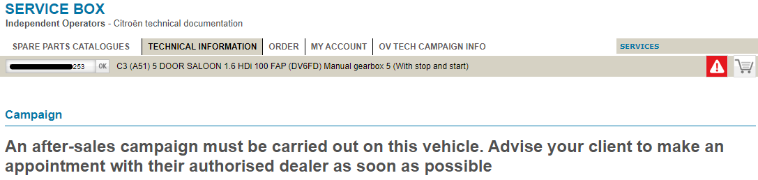

That was the original tank part number, but has since been replaced with another version - and your vehicle is being flagged up with an after-sales campaign notification, so I would give the Citroen Dealer a call and quote your VIN - they will be able to tell you what the work involves, but will be free of charge.

Gave them a call, they said no recall or sales-campaign, they told me 1.342 euro for the repair, absolutely crazy. So I guess I have to DIY it. The wiring diagram, its hard to tell but is there another sensor on the same LIN bus as the pump? Maybe the Additive injector ?

sjenja wrote: 03 Jul 2023, 11:07 Do you know if this recall also apply in Denmark where I am located ? I will give them a call.
It's the same regardless of where you are in the world. You should tell them to check Citroen Service - I've just checked again and it is still being flagged. (I have masked out your VIN apart from the last 3):

sjenja wrote: 03 Jul 2023, 11:26 Gave them a call, they said no recall or sales-campaign, they told me 1.342 euro for the repair, absolutely crazy. So I guess I have to DIY it. The wiring diagram, its hard to tell but is there another sensor on the same LIN bus as the pump? Maybe the Additive injector ?
No, there is the additive tank and the pump. The engine ECU sends the requests to the pump when conditions are correct. The injection pressure of the additive is fixed by an injection valve calibrated to 0,230 ± 0,05 bar (Relative pressure).
