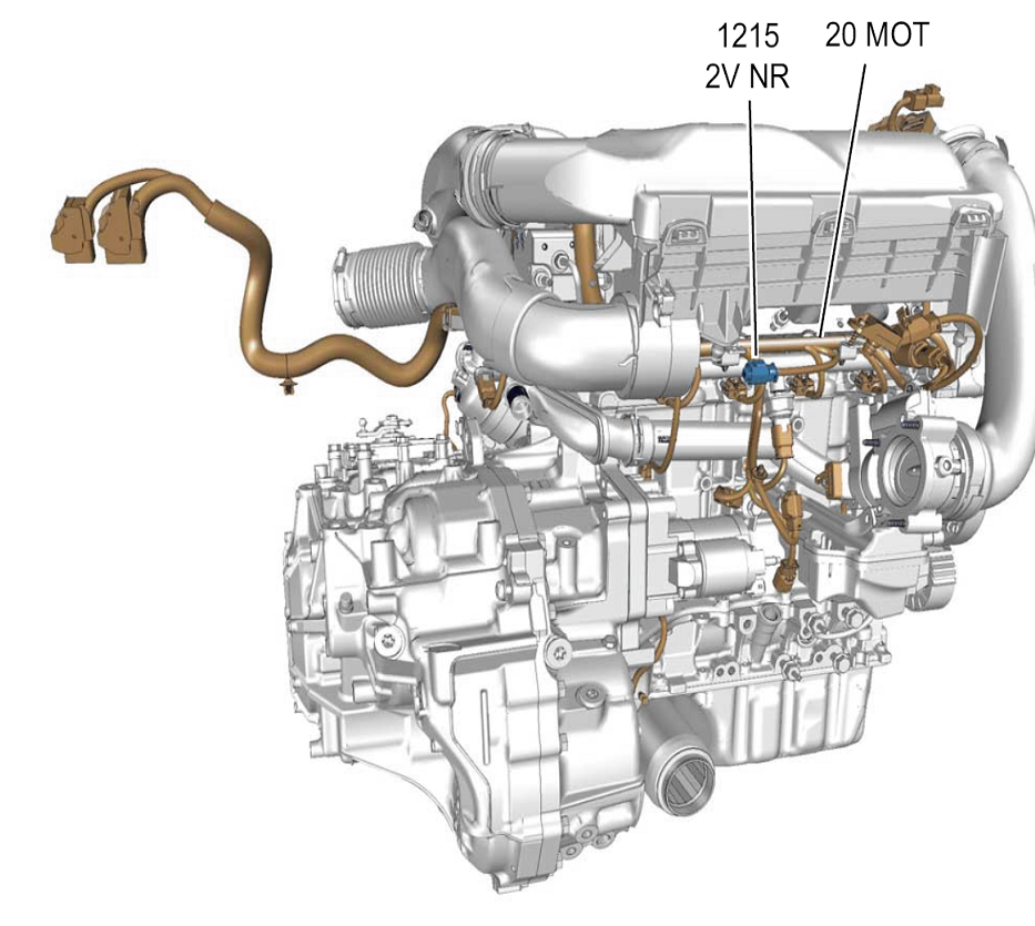

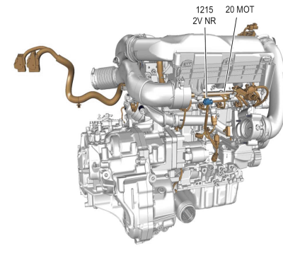

Re: Peugeot 308CC THP Engine box F5 fuse
This is the injection system.
The cannister discharge electrovalve is 1215:
