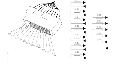

Re: C5 X7 seat controls not working
It may be a relay underneath the seat or a fuse G37 or G39 in the cabin fusebox from this bank of fuses (be careful there may be more than one fuse with the same marking - but it's from this bank you need to check):
