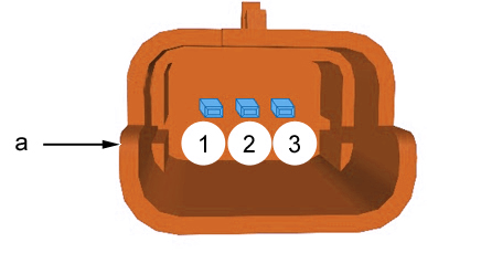

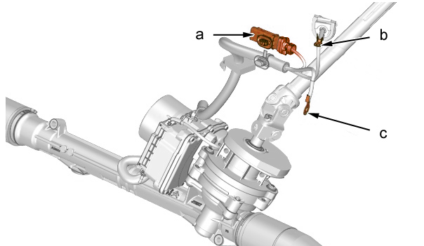

Having said that, if you have undertaken basic checks like the electrical supply is getting to the power plug. Here are the connections, but note there is no electrical connector at the ECU end.
"a" Black 3-way connector.
"b" Ancillaries battery positive terminal.
"c" Earth terminal.
1 Ignition positive
2 IS CAN High
3 IS CAN Low
"c" Earth terminal.
1 Ignition positive
2 IS CAN High
3 IS CAN Low
