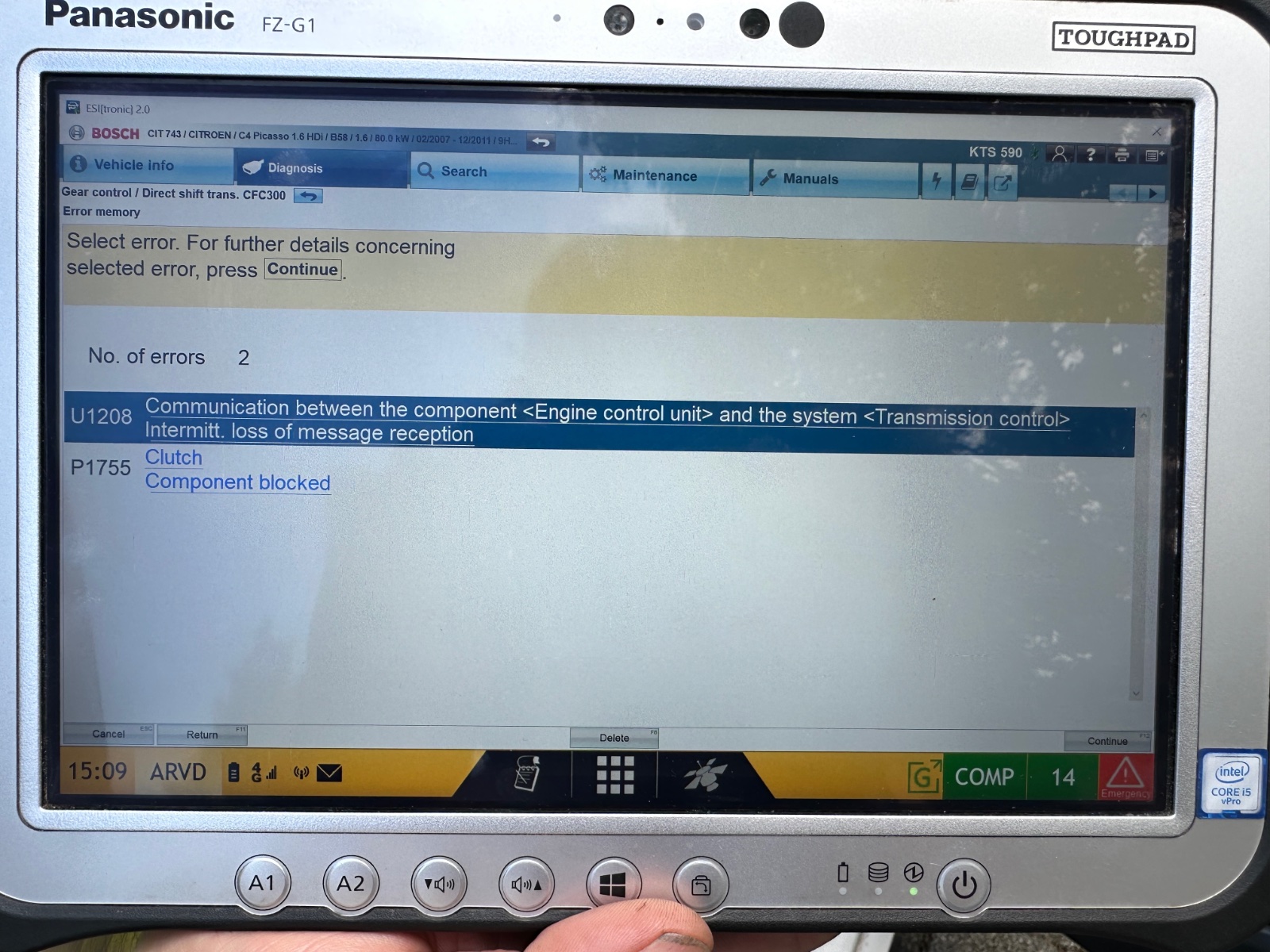

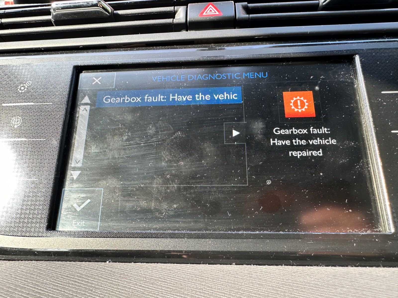

Car starts with no issues however it gives and gearbox error message once trying to put it into gear. If the car is left in idle for at least 5min, I am able to restart it and it drives like nothing happened.
Does anyone had a similar issue and do you know whether there is a simple solution to it?
I’ve attached also a pic of the error codes, AA were able to read.
x 6957
Re: Gearbox error, won’t move from neutral
You have a fault with the clutch actuator:
Fault Code: P1755
Description of Fault: Clutch jammed: Coherence. Clutch actuator fault: incorrect position in relation to the reference value. Fault occurs :

Fault Code: U1208
Description of Fault: Fault in the information transmitted by the engine management ECU : Value received incorrect. No information sent by the engine ECU (Foot throttle pedal ; Engine speed ; engine torque)

GiveMeABreak wrote: 26 Jun 2023, 17:21 You have a fault with the clutch actuator:
Many thanks for such a prompt response! Do you think there is anything I could try doing myself or is it something which requires garage intervention? As you probably noticed, my car knowledge probably goes as far as changing the bulbs or fuses..
x 6957
These systems can be quite complex to diagnose and to be honest you are probably better off going to Citroen who will have experience with these piloted systems.

bartosi wrote: 26 Jun 2023, 17:02 It’s been good 3 weeks now since it all started and now it’s just happening 7/10 times.
