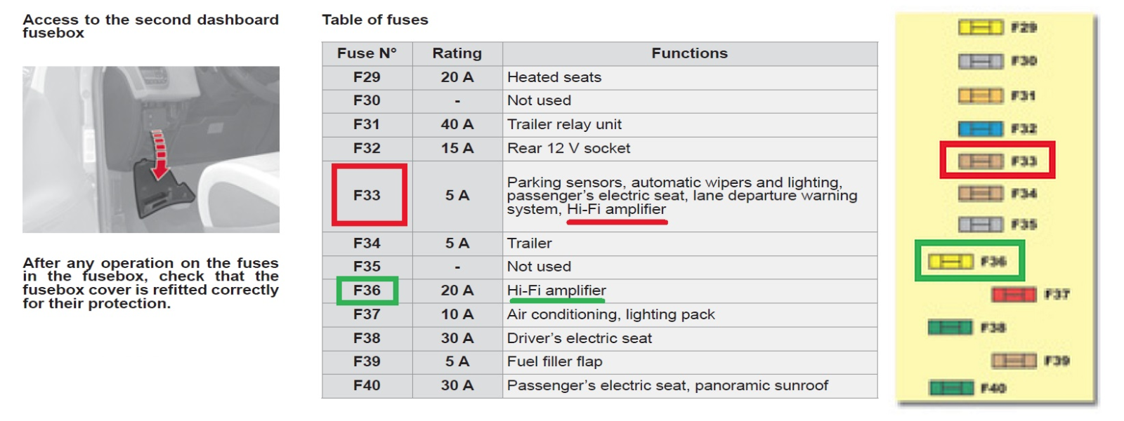

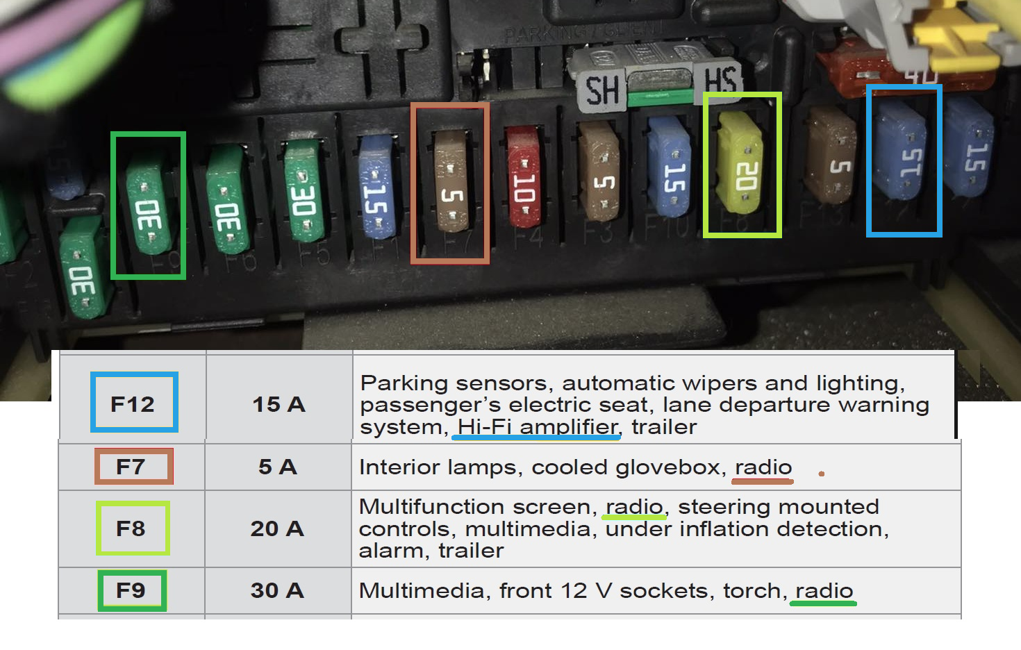

These are the fuses for the audio (radio and hi-fi amplifier). It may help someone.
There are different versions of the fuse boxes so one should check which one he have.
