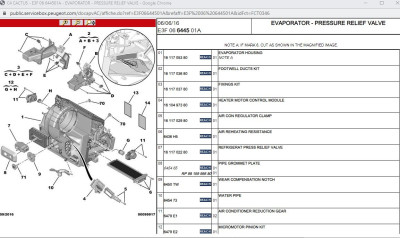

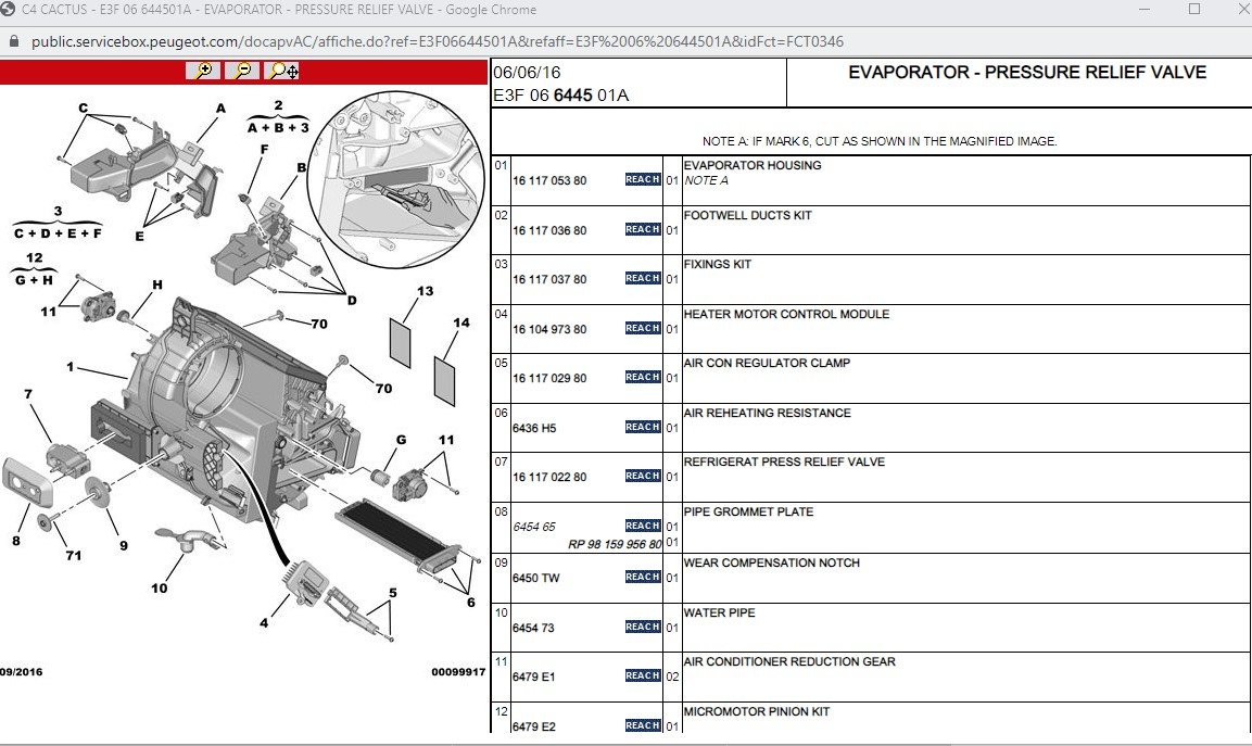

You'll need to post up the VIN. There's a good chance it only comes as part of the heater box and is ££££
- Posts: 12618
- x 1499
Re: C4 Cactus 1.6 BlueHDI 2014 leaking A/C evaporator
Only appears to be one part for all C4 cactus - as I suspect it's a complete heater unit - and costs £1000 GBP - part no 1611705380. It doesn't come up in a search on any other Citroen / Pug / DS cars so it looks specific. Evaporator failure is rare, so one from a breaker would probably be OK - if you can find one!

Complete unit...
That's not to say that if you took it out you couldn't get the evap out and find one that would fit.
Used one on Ebay in the uk here
