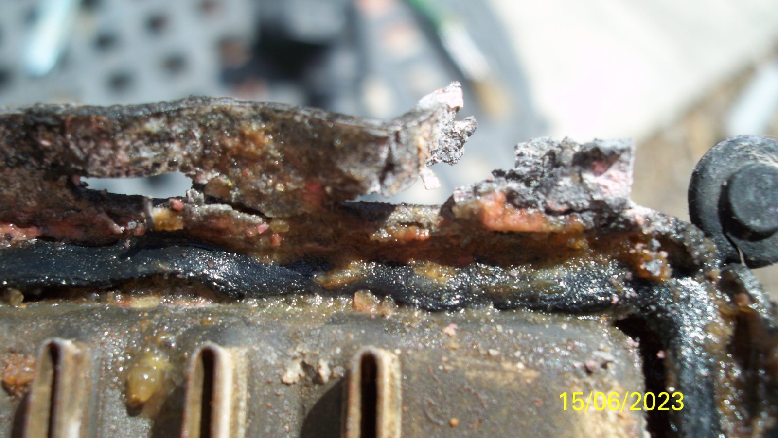

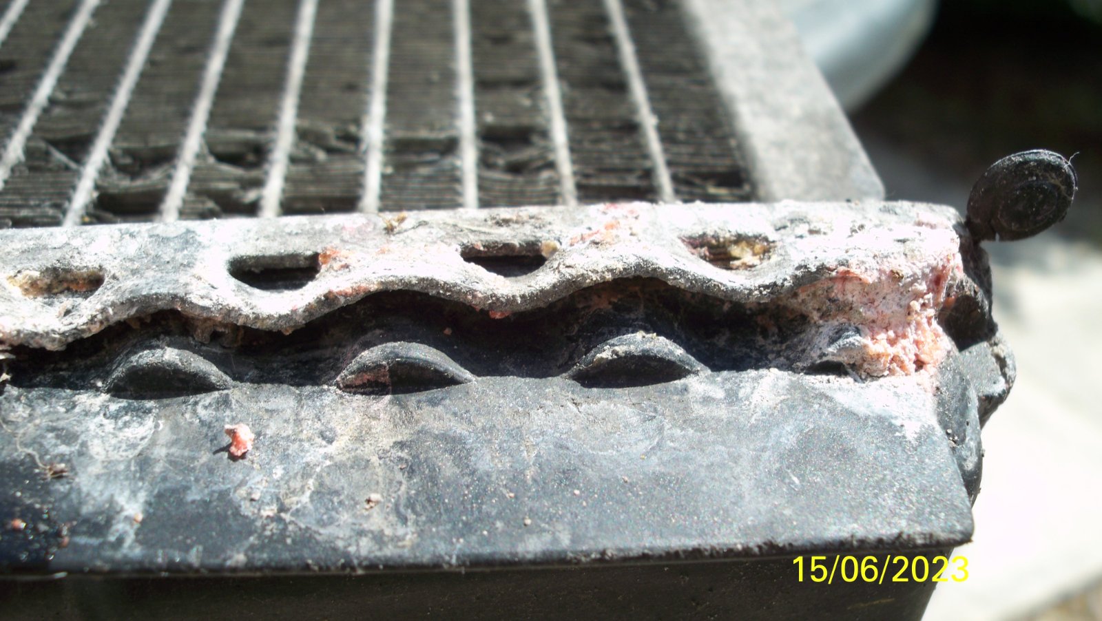

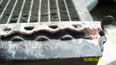

This likely applies to any car with aircon, where the condenser radiator is positioned immediately in front of the engine coolant radiator. Ive just replaced the radiator on my 2001 C5 due to a leak. OK, its 21 years old, but I was annoyed by the cause of the leak. Leaves and other detritus had collected, and been compressed to some degree by the fan, into the lower front corners of the coolant radiator. Under this (probably permanently damp) cover, the aluminium crimp had corroded and expanded, pushing the plastic end cover away from the rubber seal. Otherwise, the water channels and cooling fins were uncorroded and in good condition. Thankfully, the adjacent face of the aircon condenser seems OK, but it too could be at risk.
The gap between the two radiators is not readily visible. However, on my Citroen C5 at least, it can be checked by unclipping the coolant radiator clips at the top, and angling the radiator rearwards on its lower rubber supports, without disconnecting anything. Any debris can be brushed or vacuumed out. Worth doing every few years.

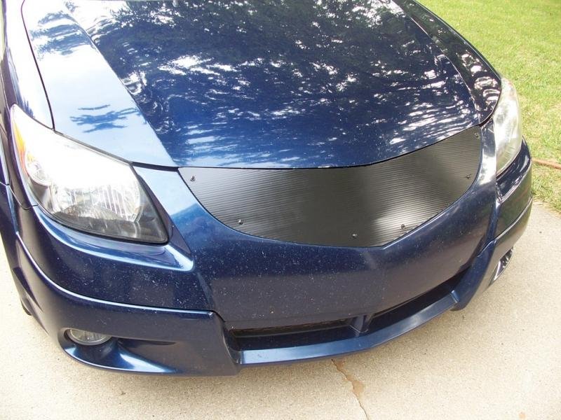

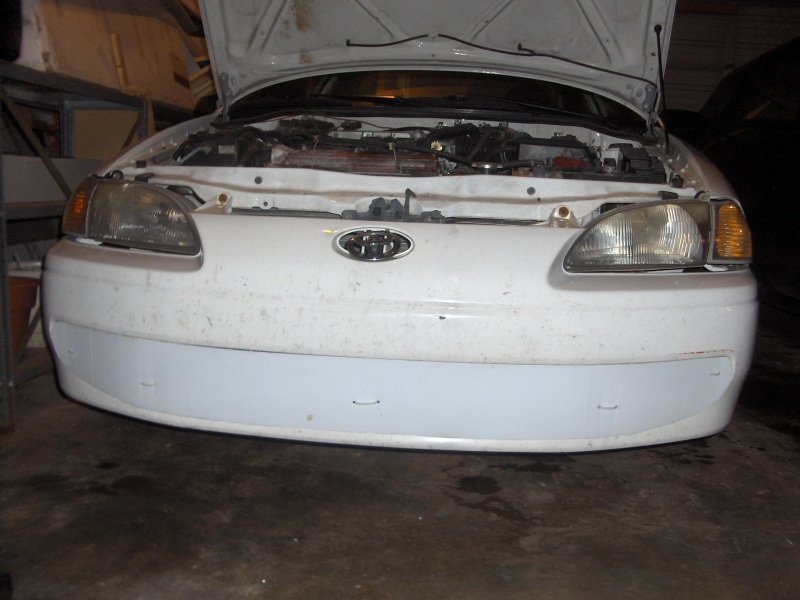

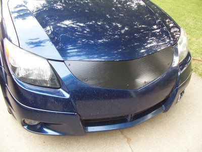

Puts me in mind of the "ecomodders" who love a bit of grille blocking:
https://ecomodder.com/forum/showthread. ... 13768.html
- Posts: 5342
- Joined: 25 Apr 2022, 09:03
- x 2356
Re: Regularly check for debris between aircon condenser and radiator
Here's a better example from Ecomodder:
