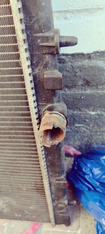

So its running max 97C, replaced all cooling parts
before:
lcwin
Posts: 57
Joined: 12 Oct 2015, 15:41
x 9
Re: 206 overheating
Unread post by lcwin »
Did you replace the water pump ? The pump blades can literally rust away . 206 cooling system is tis weakest point from radiator to connectors.
jsp
Posts: 330
Joined: 04 Dec 2014, 02:05
x 12
Re: 206 overheating
Unread post by jsp »
yes see picture. I use red coolant not cheap mix . It never rusted away here
Posts: 42019
x 6919
Re: 206 overheating
I wouldn't go by colours to be honest, it is the content of the coolant that is important as colours are no indication of the type of coolant.
