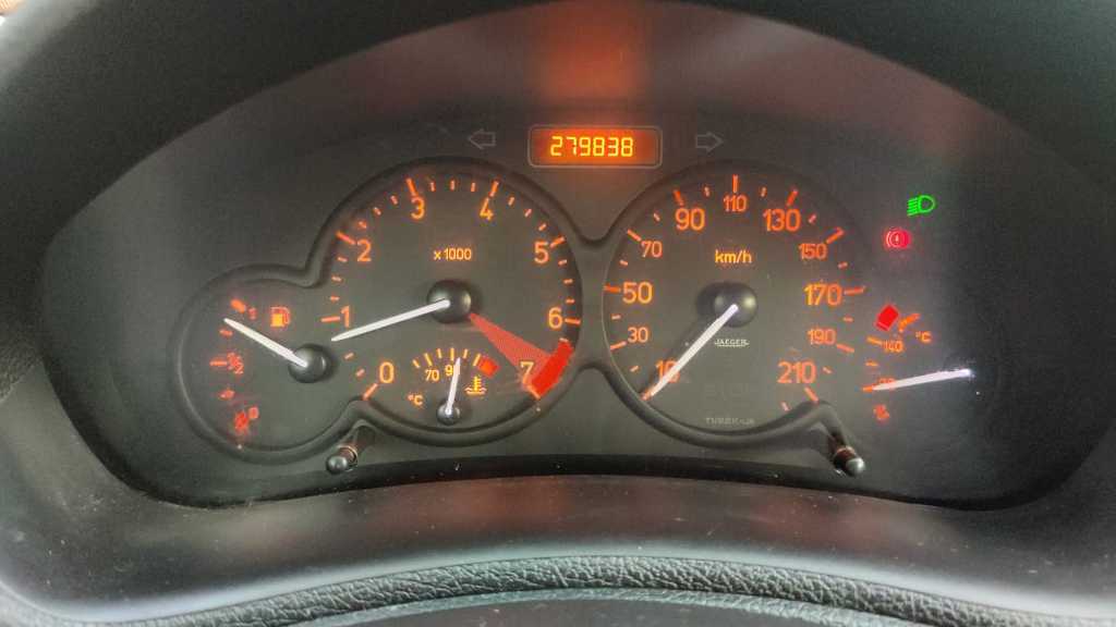

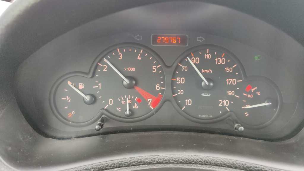

I cant see anything wrong with your pictures!? 90'C (85'C? Hard to tell) is just fine at speed, then 95'C when stopped is not unusual. Is that as bad as it gets?

Is that as hot as it gets at speed? As 90°C isn't that hot really.jsp wrote: 18 Jun 2023, 06:33 ? so a replacement radiator is not enough?
its only doing at higher speed.
Agree stationary image is rather on the hot side of things. Radiator fan working when at that temperature?

The temperatures shown in the photos do not look wrong to me, it ought to be running between about 90 and 96°C once warmed up. Below about 90°C once warm can indicate the thermostat is faulty opening too soon/too much. Above 96°C by a lot and the engine fan might not be running.
If you plug in a code reader that gives live data you can check the coolant temperature and also see if the dash gauge is correct. Typically you ought to get about 90°C the thermostat opens and the radiator top hose gets warm, 96°C the engine fan will start, a bit higher the fan speed will increase further if it is a 2 speed fan, about 110°C you will get a high temperature message, about 120°C the expansion tank cap will open to vent steam.
If the coolant temp is not at ambient (around 20°C) before the engine is first started on a morning, then the sensor might be faulty. If the engine fan is not running above 96°C then it might be faulty - if you have air con it should also run with the air con on. If you think it is over heating then putting the cabin heater on max temp and the blower on max should help to drop the temp.

As far as I can tell, the photo with the car stationary does not show it overheating, it shows the temperature about 95°C and not in the red part of the gauge. At this temperature the engine fan might not need to come on. Switching on the fan might be using the coolant temperature sensor so you need to use a code reader with live data to check what it is giving if you suspect the dash gauge is not accurate. With the car stationary and the bonnet closed, let the engine warm up and see if the gauge goes above 96°C to check if the engine fan runs.
