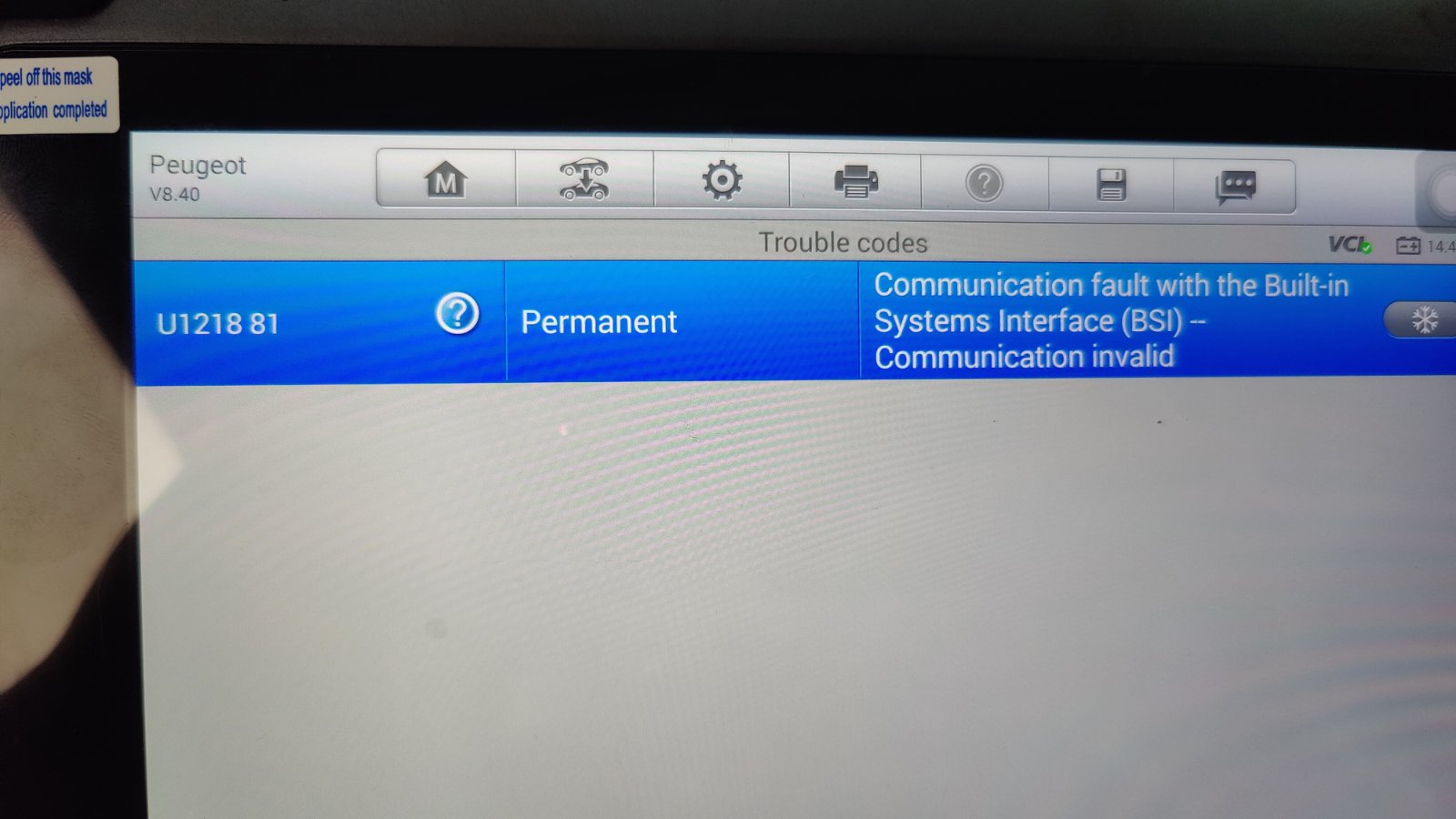

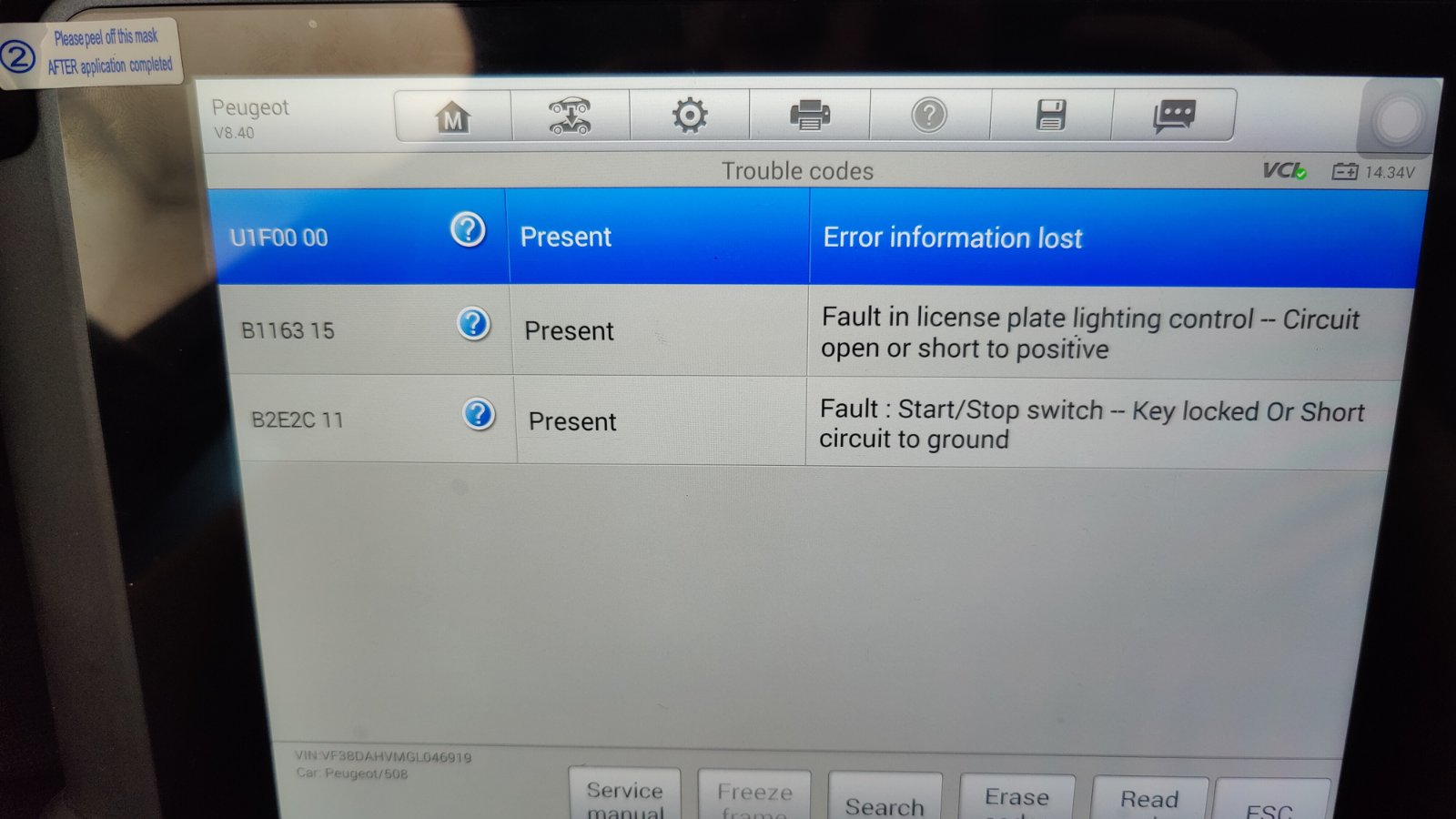

Hello, maybe someone can explane to me what these errors means.
x 6946

Have you changed any of the bulbs for LEDs? These are known to cause issues with the lighting circuit.
Fault Code: B1163 15
Description of Fault: Number plate lighting control fault: Open circuit or short circuit to the plus. Lamps controlled.
Open circuit or short circuit to positive for 2s
Conditions of activation of the diagnostics - The following conditions have to be met:
- Ignition on
- Apart from in economy mode
Conditions for Fault to clear: Absence of malfunctioning and activation/deactivation of the control
Downgrade Modes whilst Fault is active: -
Symptoms:
  • Unwanted activation (without request) of the lamps
  • The lamps cannot be activated
Suspect Areas:
  • Electrical harness
  • Built-in systems interface
  • Number plate lamps
Fault Code: B2EC2 11
Description of Fault: Trailer right-hand direction indicators control fault: Short circuit to earth. Lamps controlled.
Short-circuit to earth detected for 2 seconds.
Conditions of activation of the diagnostics - Ignition on
Conditions for Fault to clear: The following conditions have to be met:
- Absence of short-circuit to earth
- Application of the method for reactivation of the broken outputs
  • Deactivation of the control of the output affected by the fault
  • Doubling of the activation frequency of the right-hand indicators
Symptoms:
  • The lamp cannot be activated
  • Right-hand direction indicators operating at double frequency
Suspect Areas:
  • Trailer socket
  • Component connected to the trailer socket
  • Trailer Fuse Box

Actualy i did. Short light i set some leds. But they have black box for error canceling. So all these errors are not to worry? Car running ok i just check today and google didnt show me anything special.
