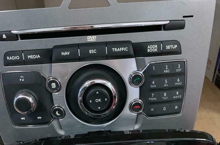

and is it possible to install a previous (older) version of the radio? will it work in tandem with the display on the torpedo? because it is impossible to find NG4 here, or at the exorbitant price of 400 USD
my car has front and rear parking sensors & I need to use it)))
like this one:
like this one:
- x 6954
Re: NG4 sytem on Peugeot 308 didn't work anyway :(
That unit is the older RNEG (MyWay) also made by Harman Becker, which has the SD Card Slot in the centre.
The RT6 (eMyWay) made by Magneti Marelli looks the same, but doesn't have the SD Card.
Either should be options for you, but be aware that having had the NG4 fitted, you might also have had the 'Services' Module fitted in the car, which would be linked to the NG4. This handles the telematics emergency calling and locating features and means the microphone in the car may be routed via the services module along with other wiring.
