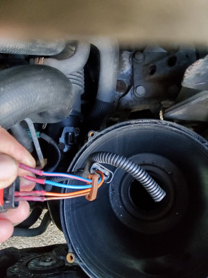

I took mine out the other day. Pig to get at if screws are rusted and rounded off.
Sensor is located just to the left side and below the air filter box. In the image you can see the sensor with the clip removed. Only held in by screws. I also had to replace my clip and spluced into the original wiring loom.
