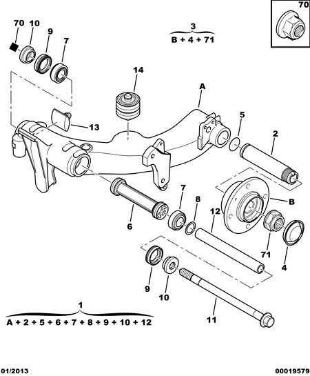

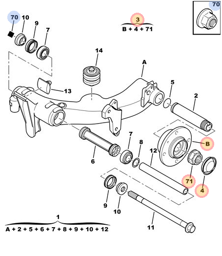

James, procedure here:
viewtopic.php?p=758640#p758640
Parts
(3) OEM Original Rear Hub Bearing, part: 374870, £222.91
Citroen cheaper alternative, part: 1681931080, £88.99
All direct from Citroen inc. VAT
Parts

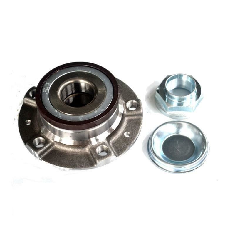

Re: C5 Mk. 1 rear wheel bearing change advice
i see bearing are sold sepperately aswell, is there anything stopping me from using a press to force out the old bearing on press in a new one ?
Jay-Bruce
- Posts: 544
- Joined: 20 Mar 2019, 00:30
- x 280
The are two things stopping you doing that, the first is your own intelligence, I mean, who, bar an absolute fool, would put themself through the ballache of pressing out old bearings and pressing in new one, while trying to NOT damage the magnetic markers in the new bearing that are the ABS trigger "teeth", for the sakes of saving about £10 / 70NOK saved buying a new bearing vs a bearing hub assembly? The second thing is that the rear bearings are pressed into essentially a blind hole in the hub, so you can't readily get an arbor from the press onto the bearingKristian27 wrote: 27 Aug 2023, 11:05 i see bearing are sold sepperately aswell, is there anything stopping me from using a press to force out the old bearing on press in a new one ?

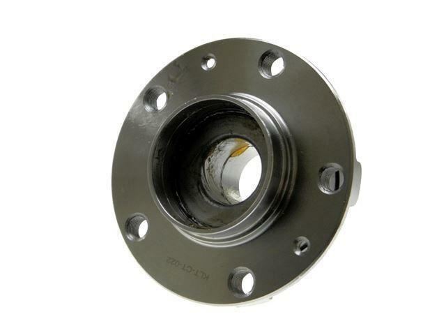

On the rear hub, the outer race is vitrually inaccessable for pressing out:
So, in much the same way as pulling the hub off the stub axle risks leaving the inboard inner race on the axle as we spoke about previously, trying to press the bearing out of the rear hub risks leaving the outer race inside the hub, which would be a [insert expletives of choice] to get out of there, but when you get the bearing out, pressing in the new one should be dead easy.
Kristian27
- Posts: 48
- Joined: 14 Jan 2021, 23:48
- x 2
In that case I think i will just buy the complete assembly and overhaul the old one to replace the other side when needed
save myself some pain.
Does anyone have any budget brand recomandation or is it safer to stick with Fag,Skf,nsk..
