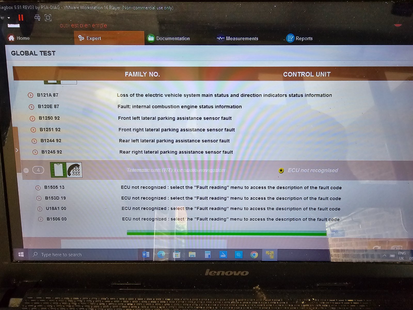

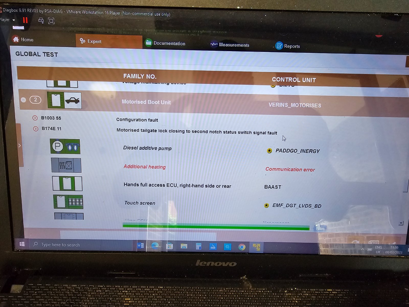

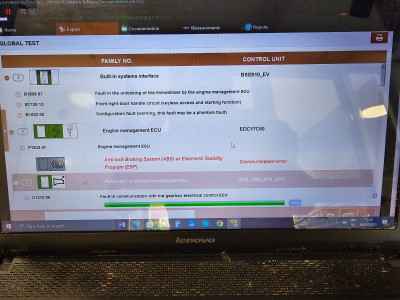

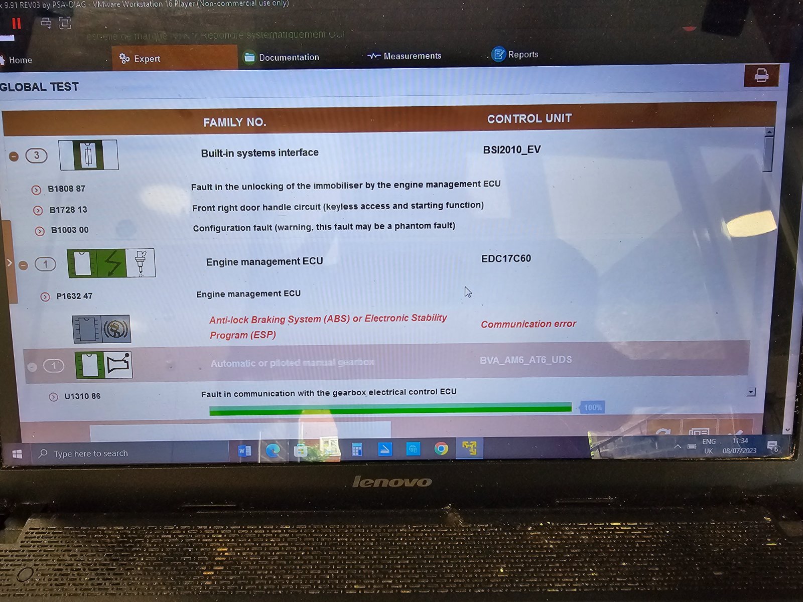

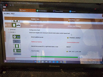

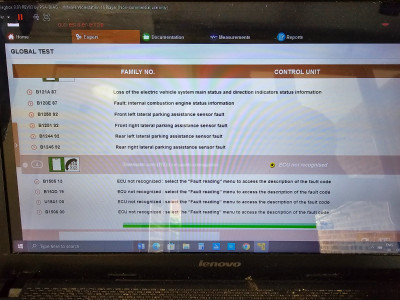

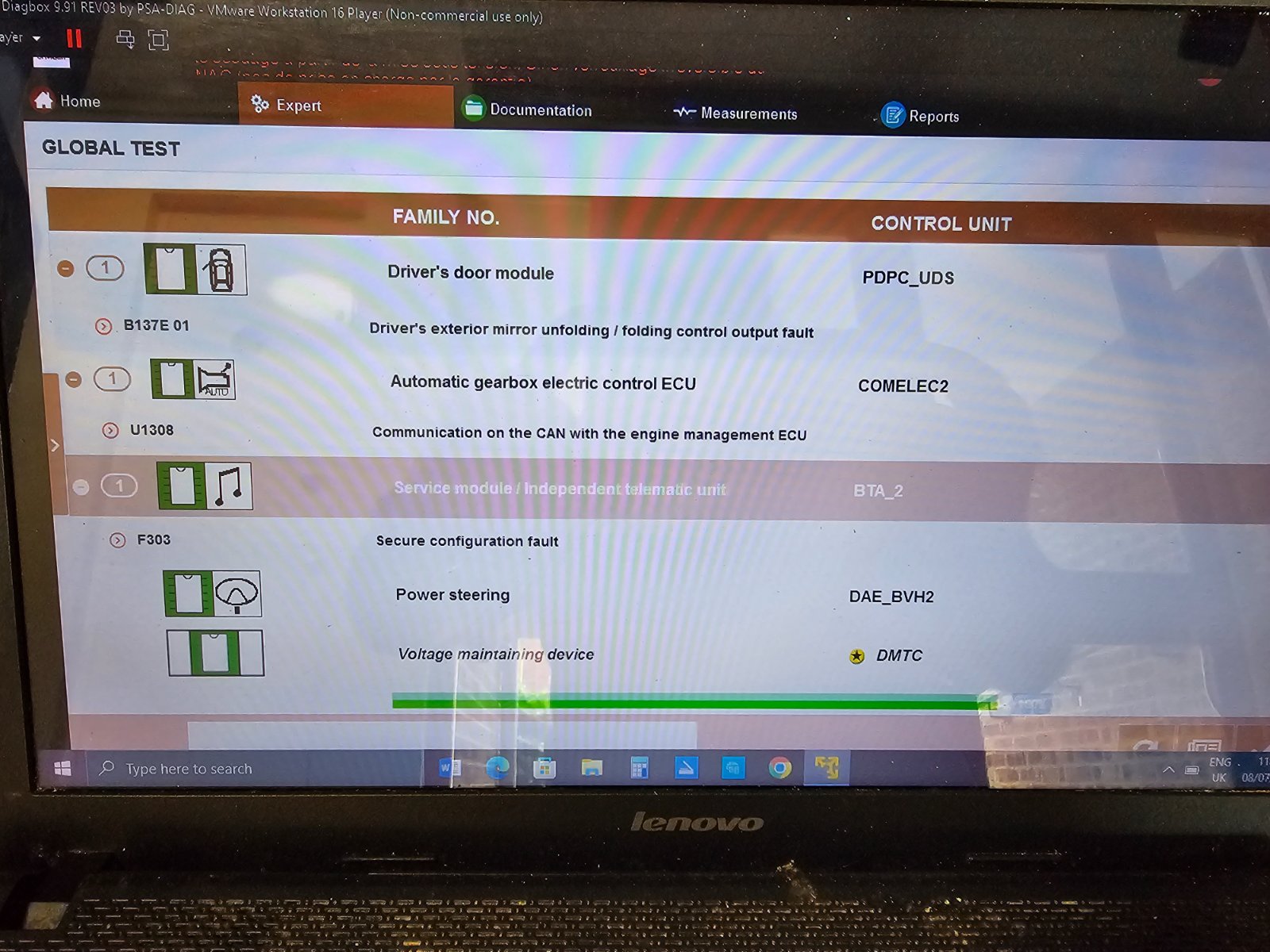

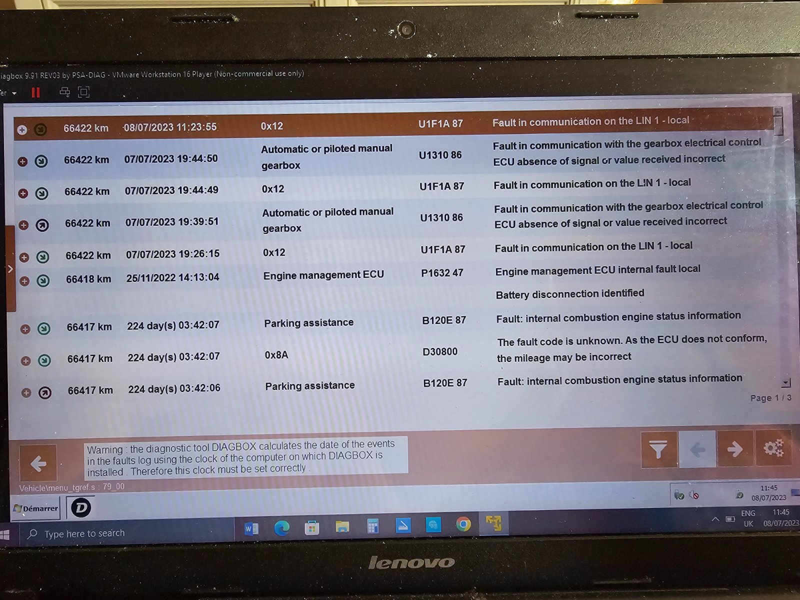

I had it again today and it was worse, the car started shaking whilst at traffic light and then the engine cut off and battery sign showed up, I managed to get it back home and run a diagbox diagnosis on it, this time few codes appeared mostly about gearbox and communication with LIN, file attached

You image is only showing one code at the bottom of the first page. I've deleted the image with your VIN and other details for your security, so please just provide the 7 digit fault codes like the U1310 86, that's all I need. I have the VIN from the picture.

Here are the codes attached plus the report, it can be seen that since the shaking started there were no codes for the gearbox, first time they appeared is yesterday.GiveMeABreak wrote: 08 Jul 2023, 10:28 Now I have your VIN there has been some misunderstanding from your first post - you don't have a piloted manual EGS gearbox! You have an AT6 fully automatic gearbox. So ignore everything that I have mentioned - I have now deleted those posts as they are not relevant to this gearbox.
Just post up the codes and we'll see what we have.
There are other codes e.g parking sensors and boot but both these are working fine including park assist.
The known fault are drivers side mirror no folding back, driver's side keyless access intermittent sometimes works and sometimes doesn't and also the auto wiper it doesn't work since some idiot at big motoring world where I bought it from back in Dec 22 tried to fix auto dusk sensor and started downloading stuff to the ECU as he said and then ended up changing the sensor which fixed the light but not the wipers.
report : https://www.dropbox.com/scl/fi/w5izhgth ... c5ktk&dl=0
pictures below
- x 6948
Re: C4 picasso 2017 intermittent judder in random gears
Ok, so with this new information, I'm not going to go any further as I think the idiot who tried to configure your BSI has basically screwed it up and doesn't know what he's doing. If he's changed settings that are not supposed to be changed or left the BSI in an unconfigured state, then it can cause a myriad of problems.
There are too many faults here for me to realistically look at and I think many will be caused by the person who doesn't know what he's doing at the place you bought it from.
If you have warranty, take it back as not fit for purpose or get them to foot the diagnostics bill from Citroen to have it programmed correctly.
If no warranty, you may have to bite the bullet, take it to Citroen and pay for a diagnostic £120 inc. VAT per hour and advise them that the idiot sales man has probably mucked up the configuration. Citroen should be able to download and check the BSI configuration from their servers and ensure it is correct. Then you may be in a better position to determine what are real faults and which ones may have been caused by his incompetence.

I did ask and all I got is there are old errors in the journal which do not relate to the issue, as soon as I left the garage it started doing it again, I am lost I do not know what to do please help? I was thinking about changing the fuel filter with the major service which is due anyway.GiveMeABreak wrote: 25 Jul 2023, 21:53 That's not the same as what I'm suggesting.

I understand that - the journal can record historic faults, but your screenshots are after the result of a new Global Test, so are not historical. There's nothing I can do here with this number of faults - there are simply too many, so either the vehicle data networks or one of the main ECUs / supplies units have a fault leading to the creation of ghost faults, as I can't see this many faults being realistic.

- x 6948
That's unfortunately not the case either - because the vehicle uses multiplexed electronics and data networks. Very simply put, encoded signals are sent along various CAN data networks. Systems are categorised according to priority, so that safety critical systems are on a higher speed / priority network than say the comfort systems. The interconnected ECUs determine whether the data is meant for them and they also send their own data destined for another ECU.
So imagine much like a computer network, if the cabling is damaged, shorted or has other issues, then this can result in non-communication with the ECU in the worst cases or garbage being passed along or one ECU not getting data that it expects or needs - and in such cases that can cause the other ECUs to throw up errors themselves when there may not be a problem with the equipment it is responsible for, but the data that it needs is not there or not making sense.
That's why it needs proper testing to see if it is indeed a main controlling ECU at fault (like the engine ECU or the BSI for example) or whether this is a problem along the data networks. You don't want to be replacing parts when there is no need and ECUs are not cheap.
