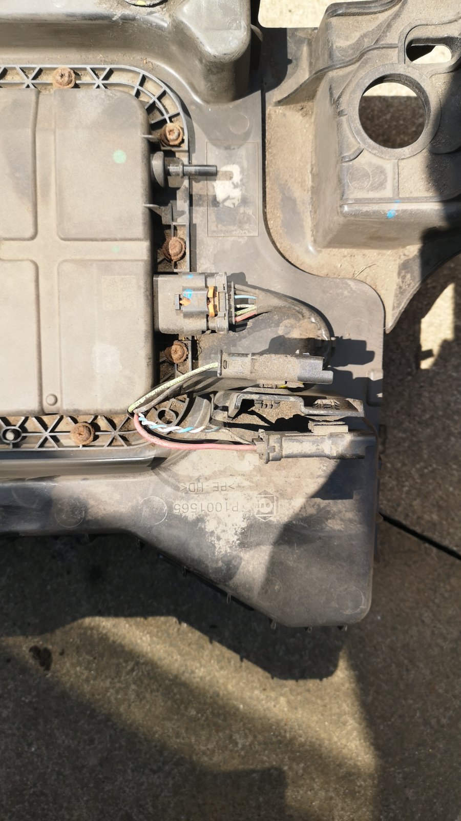

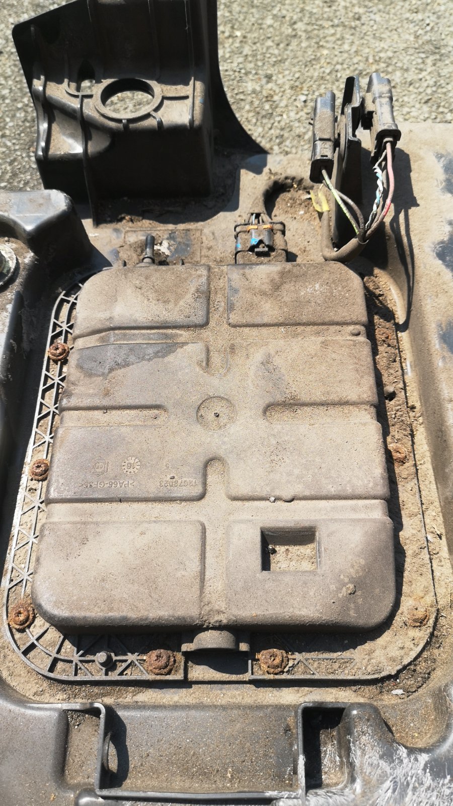

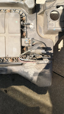

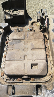

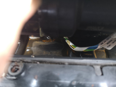

Removed adblue tank, torx screws corroded - any idea how I can access the pump?
Mexico14
Posts: 101
Joined: 11 Aug 2020, 14:34
Unread post by Mexico14 »

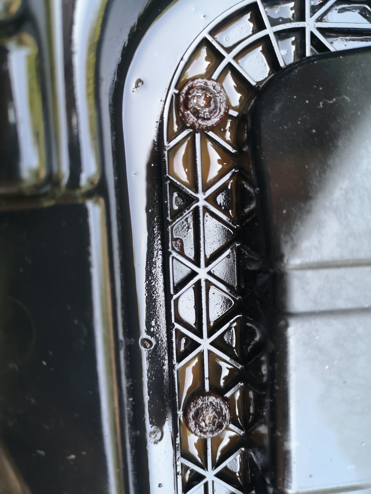

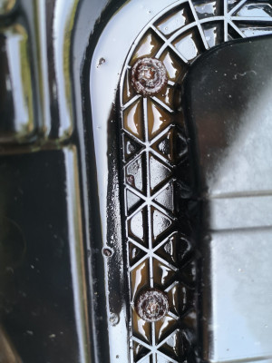

Have put wd40 but it hasn't helped.
wheeler
Posts: 7932
Joined: 21 Sep 2002, 19:07
x 1056
Re: Removed adblue tank, torx screws corroded - any idea how I can access the pump?
Unread post by wheeler »

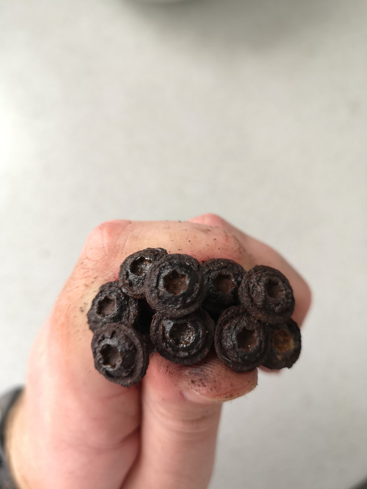

First you need to wire brush then to get the worst off, then get a fine pointed pick & scrape out the rust on the inside points of the screw, when trying to remove tap the socket into the head with a small hammer before trying to remove. You should get them out no problem.
Mexico14
Posts: 101
9 out with 2 proving stubborn. Definitely helped using the halfords advanced t25 bit! I'll try your suggestion on the final 2.
Cant wait to see what lies beneath the cover...
Mexico14
Posts: 101

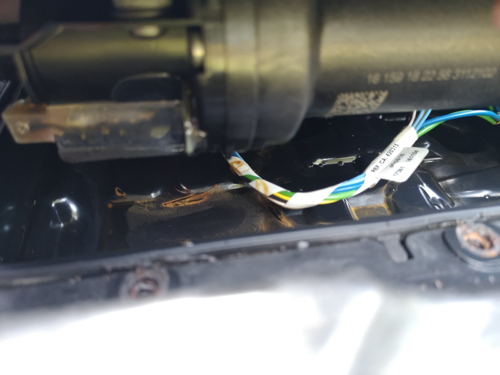

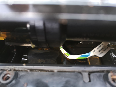

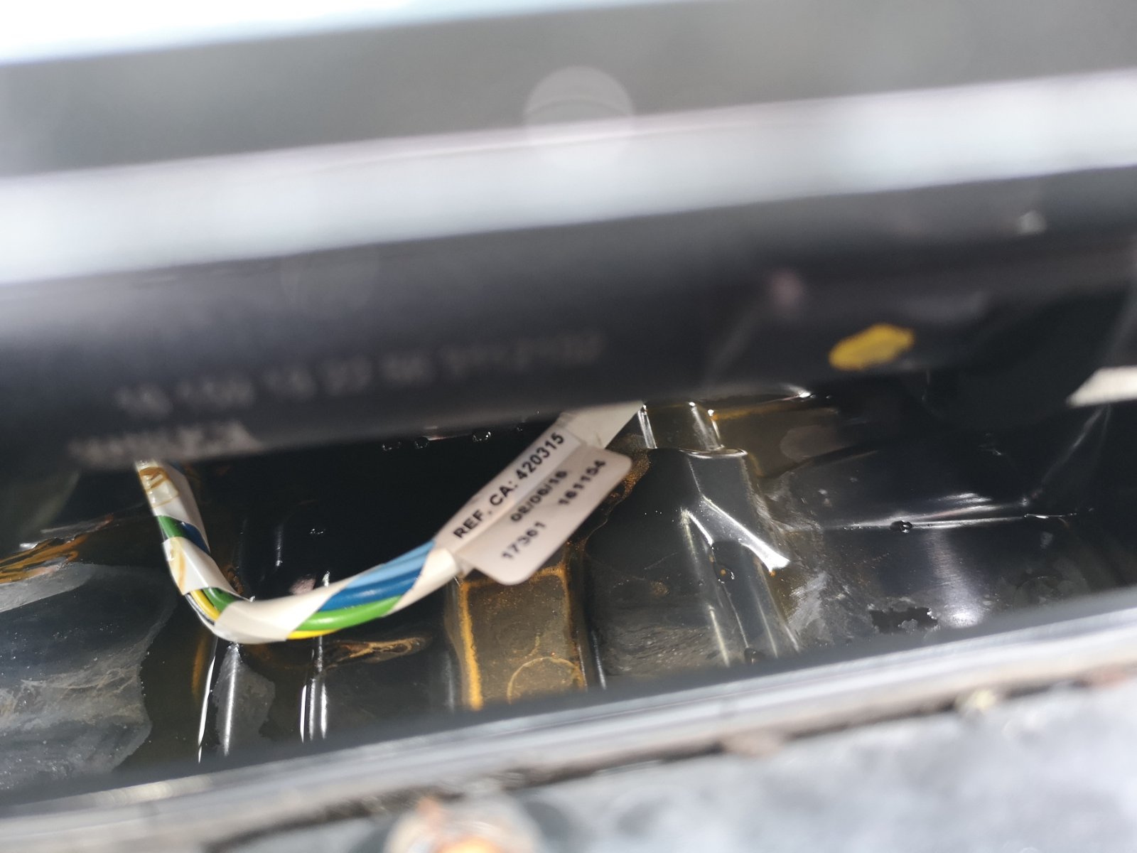

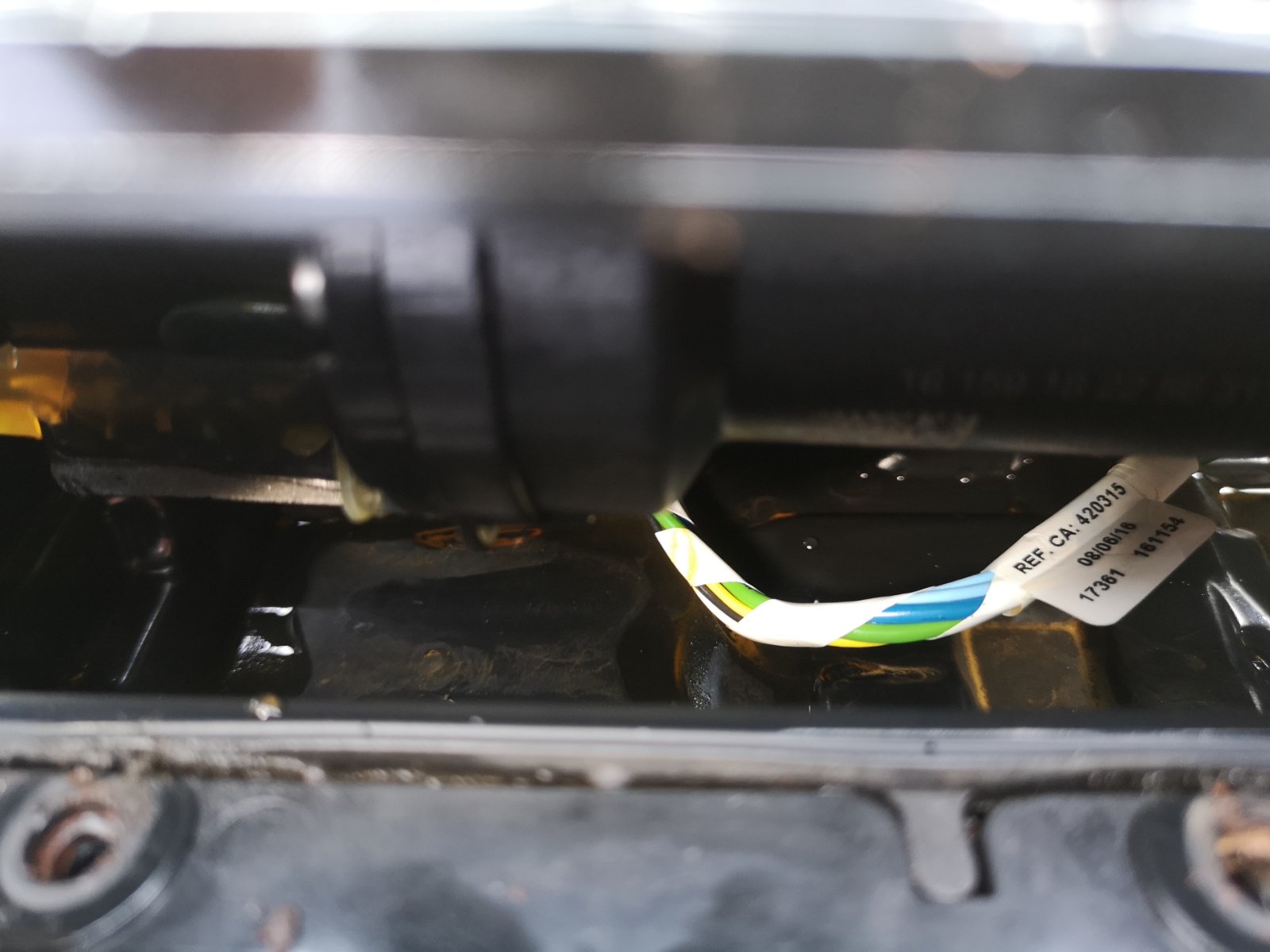

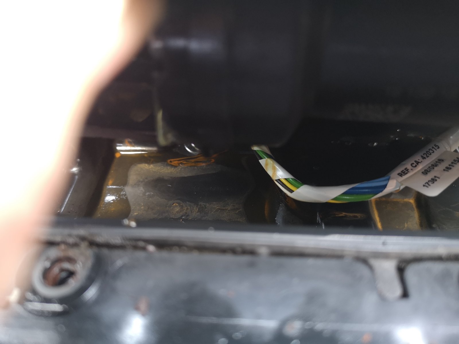

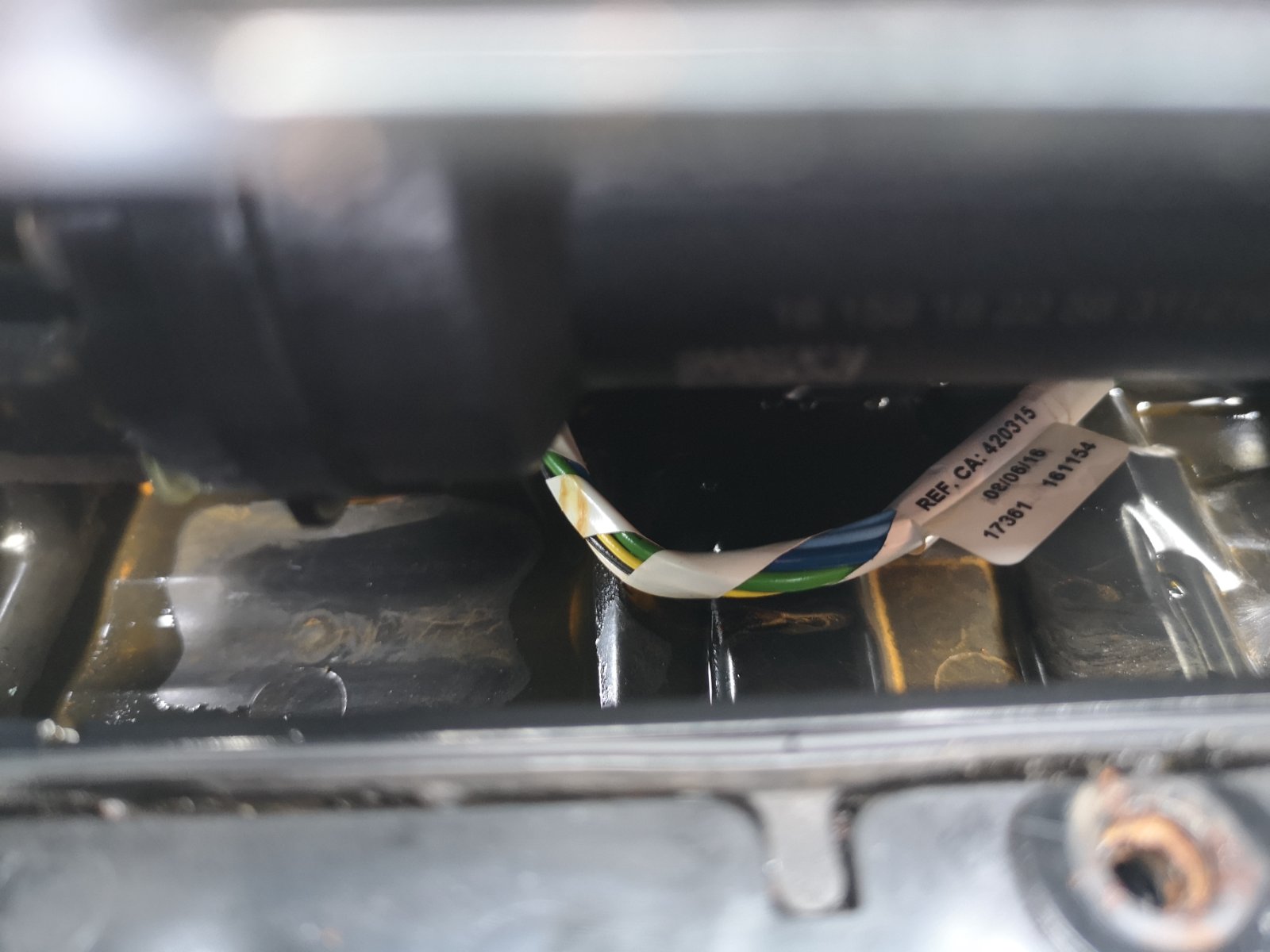

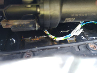

Can't move those final 2 screws but could open the cover enough to see there's water in there.
