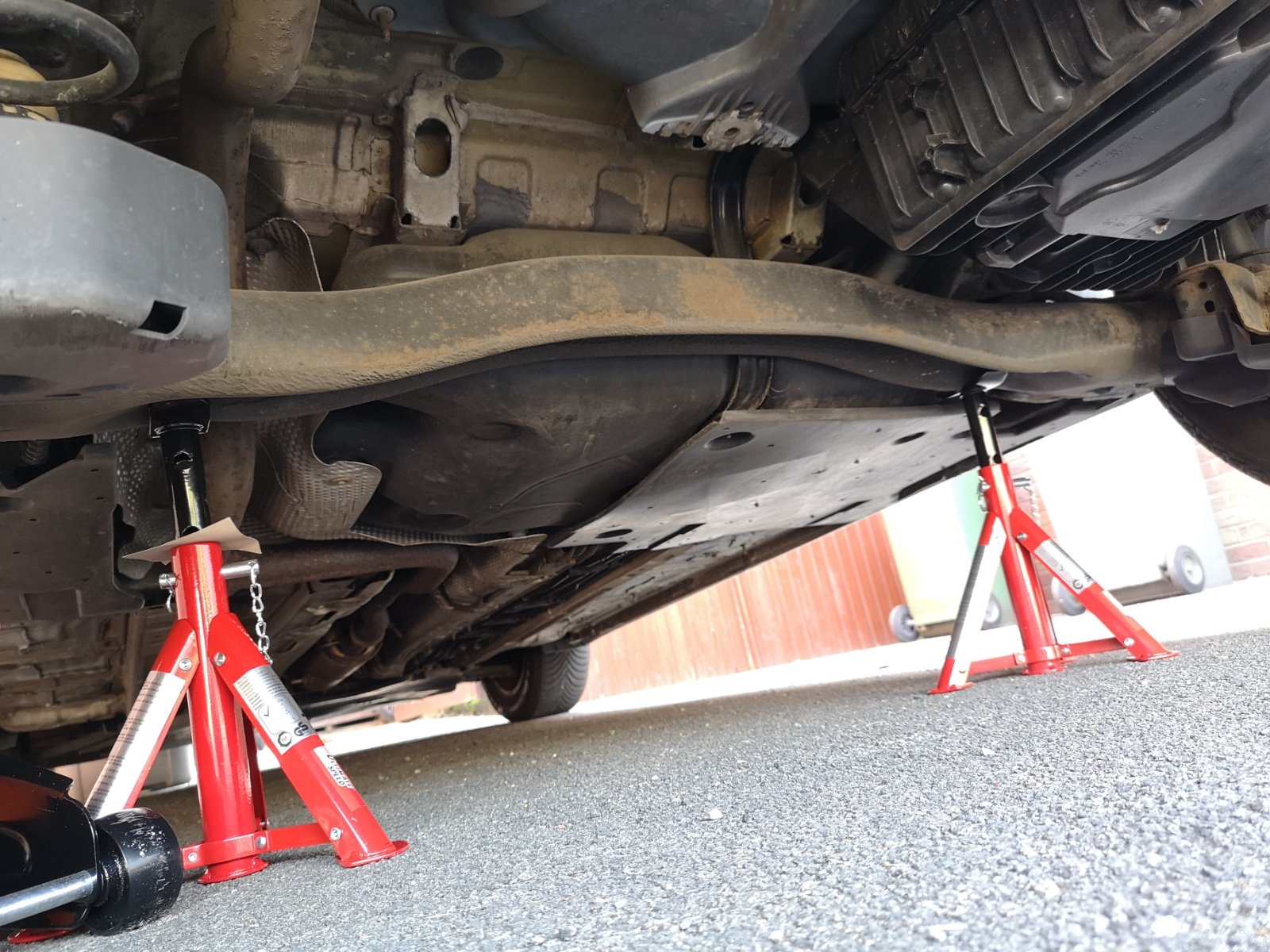

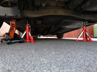

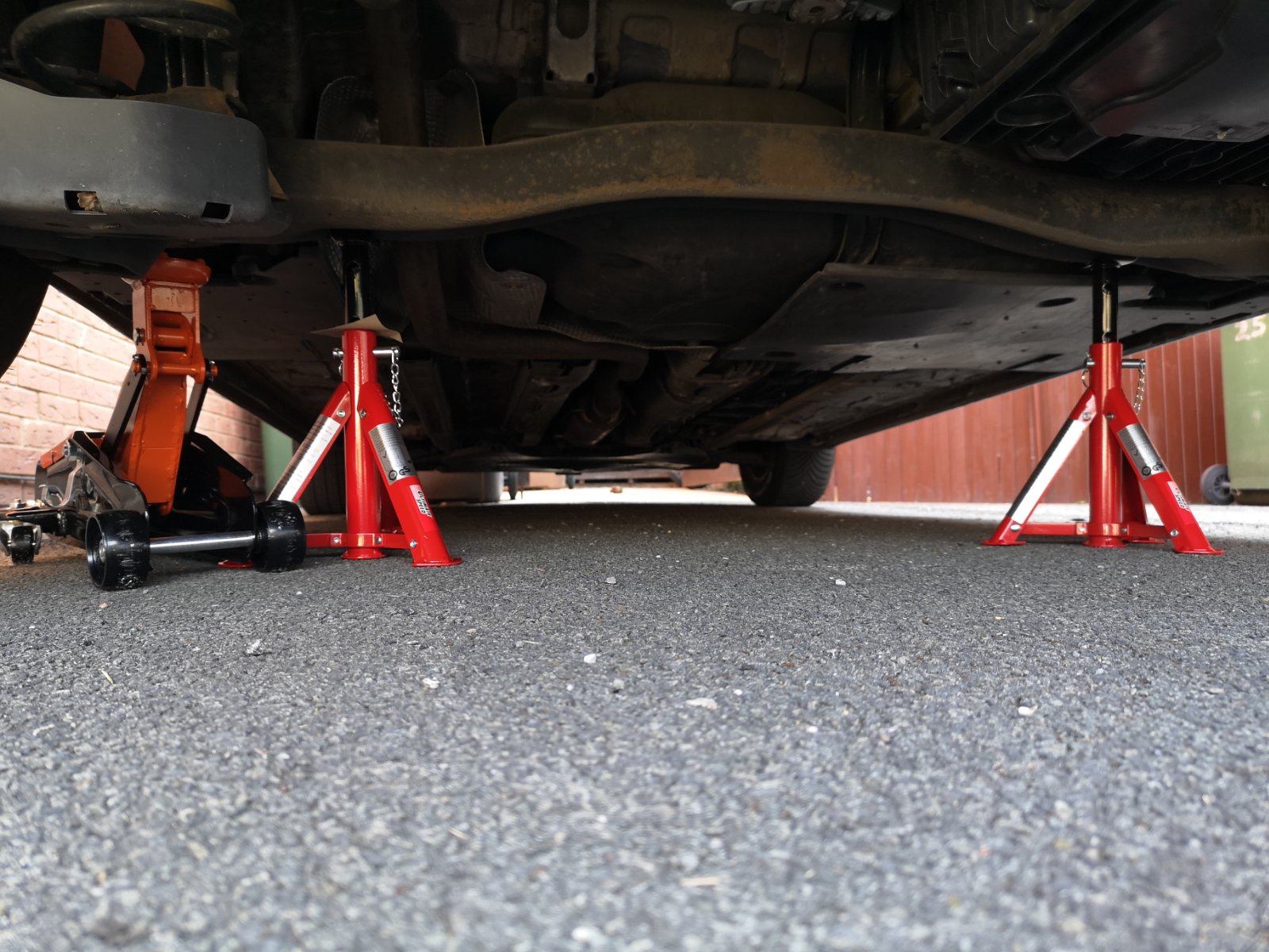

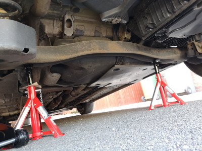

Car on axle stands - does this look safe to work under, any suggestions?
Mexico14
- Posts: 101
- Joined: 11 Aug 2020, 14:34
Safety first, just checking if there's anything I've overlooked?
- Posts: 3297
- Joined: 11 May 2022, 19:54
- x 1068
Re: Car on axle stands - does this look safe to work under, any suggestions?
I would never say working under axle stands is safe. It can be made safer though, like putting the tyres under the chassis also wooden planks/blocks just incase of axle stand movement/collapse

Whenever I put a car up on stands I always test the integrity of the stands by giving the car a good hard rocking. If it stays well in place then I'm happy it's OK... Like Ryan, I still have some secondary support in place...

Always do "the wobble test"CitroJim wrote: 12 Jun 2023, 05:19 Whenever I put a car up on stands I always test the integrity of the stands by giving the car a good hard rocking. If it stays well in place then I'm happy it's OK
I've no direct experience, but read lots of unfavourable reports about those fold up style axle stands, take extra care with those.
As others have said chock wheels (bricks, chunks of timber, specific wheel chocks) that remain on the floor (as well as handbrake + in gear/park)

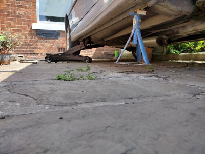

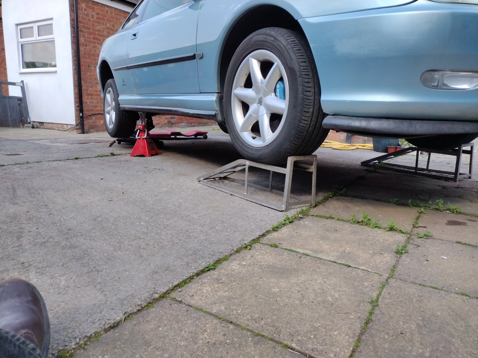

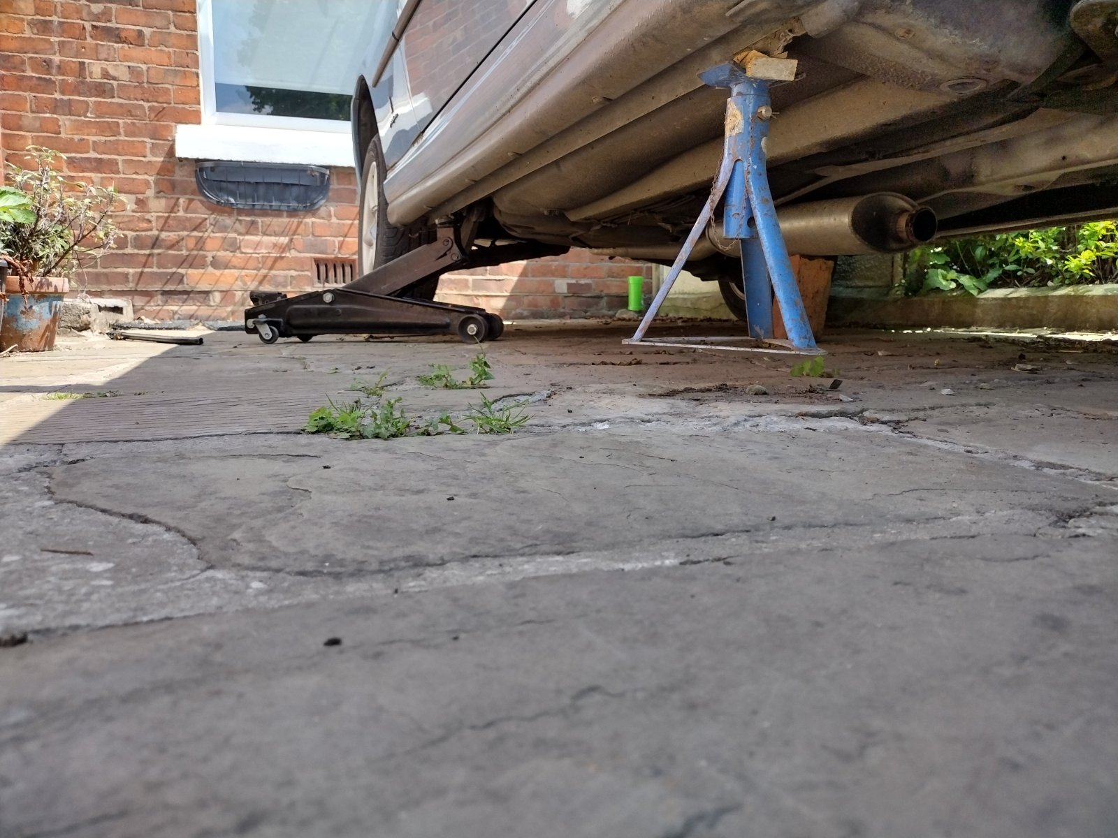

Just to add, two ramps and two axle stands (especially two chuffing enormous 5 tonne ones given to me by a neighbour) = solid as a rock!

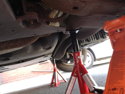

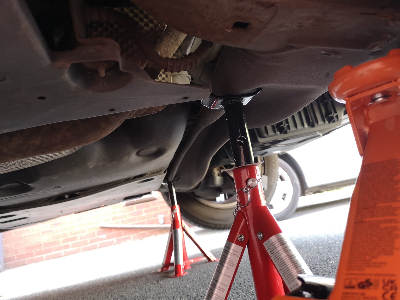

I have got a set of those axles stands (got them from Lidl years ago), and they work well. The don't take up too much space when collapsed, and when the supports are folded out the stand will not fall over (unless pushed over hard to one side). Just make sure the security pin is clipped into place so the main pin cannot be knocked out accidentally.

Question, do you trust you life to something that cost £1 to make in China.
.....if not add in fail safes like tyres/ramps/blocks. Axle stand are really not designed to allow you to go under the car.

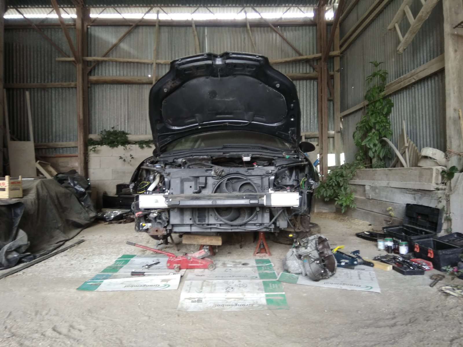

Yep, if used correctly and are stable on solid level ground they're fine.
there were also another 2 further back (out of view) and the front wheels under the sills.
This was a clutch job, so g/box out.

I disagree 100%.....esp for the type in the photo....as I said, always have a back up support that will save your life.
Go under the car with Chinese monkey metal jack stands = NOT A CHANCE.

Ok, will agree to disagree as we obviously have differing levels of tolerable risk. I'm happy I'm using equipment as intended and if bought relatively recently would be CE marked and hence safe if used as designed.
I agree a wheel rim or blocks of wood thrown under the car are "cheap insurance" should the stands collapse or topple for whatever reason and a dented alloy a better option than a dented head!
