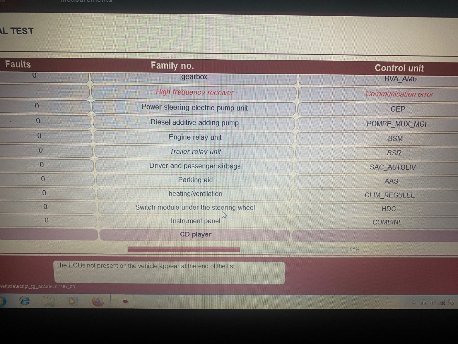

Re: Remote on keys not working 308
Also, it was not an immo off Ecu. After selecting HF receiver as one of the options to the car when programming ecu, it is always saying that there is no communication with it during my fault readings. Did i select the wrong option for the car? There are no others i can see.wheeler wrote: 10 Jun 2023, 09:22 Definitely need more info on what was replaced?
In Europe we almost exclusively use 434MHz. On european versions there is no seperate RF reciever, its built into the comms unit so its totaly normal to see no communication with RF receiver on these.
Some other parts of the world use mainly 315 MHz & they have a separate receiver. Not sure what Australia are on?
As far as im aware the keys are only programmed to the BSI too so not really sure how this has affected it by changing the engine ECU.
Are you saying there was an option to configure RF receiver in the engine ECU. If so that doesn’t sound right.
Ok, thank you for the reply, i checked the type of remote i have with ones for sale and it is the 434mhz one. So it must be built into the bsi.wheeler wrote: 10 Jun 2023, 10:16 In Europe we almost exclusively use 434MHz. On european versions there is no seperate RF reciever, its built into the comms unit so its totaly normal to see no communication with RF receiver on these.
Oh sorry, there is an option in the BSI, not ecu configuration for the hf receiver, which i switched on to try but that explains why there was no communication, as it does not use it on the 434mhz like you said. I also checked in the bsi live data and there is 1 remote programmed to it.
Is there possibly an antenna or something on the bsi that needs to be plugged in? As i did have the bsi out during diagnosis at one point or anything else i can check on bsi?

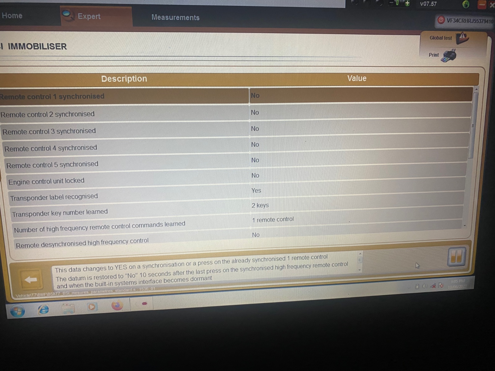

I have been looking in live data and this is what i found below. I have tried to sync the remote but it never works (ignition on, hold button on remote 10 secs and then let go and switch off and wait 30 seconds). Does nothing.wheeler wrote: 10 Jun 2023, 13:19 Can you see live data of the remote control signal? This may be in BSI and/or the switch module at the steering wheel.
I mean can the diag see the remote being pressed? You may need to look in the live data of the switch module at steering wheel.

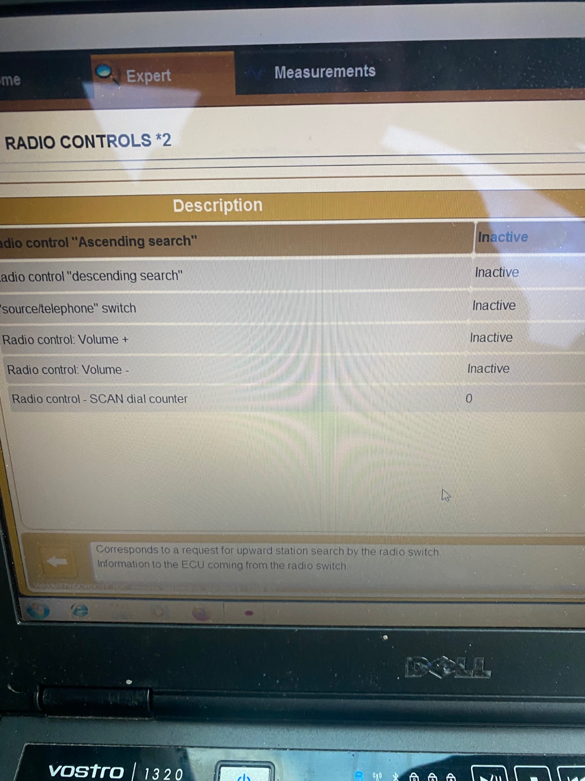

Missed your reply sorry, tried looking in switch module live data and did not seem to see any difference when pressing and not, maybe it is the remote that died after all suddenly, needed an RF tester to confirm. Do you know if a 2009 peugeot 308 will need an FSK or ASK remote, as the suppliers of remotes all have two options, i have read earlier than 2011 is Fsk? But not sure.wheeler wrote: 10 Jun 2023, 15:12 I mean can the diag see the remote being pressed? You may need to look in the live data of the switch module at steering wheel.
I reckon this should be FSK
