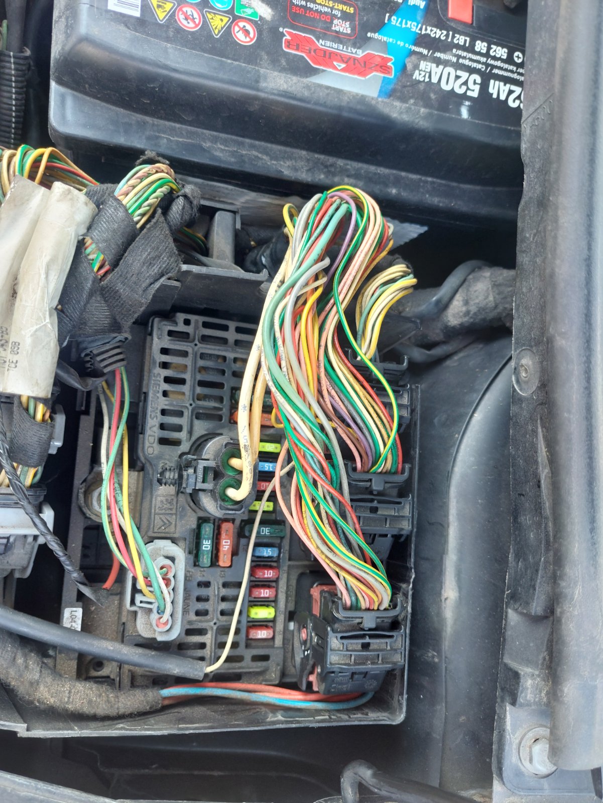

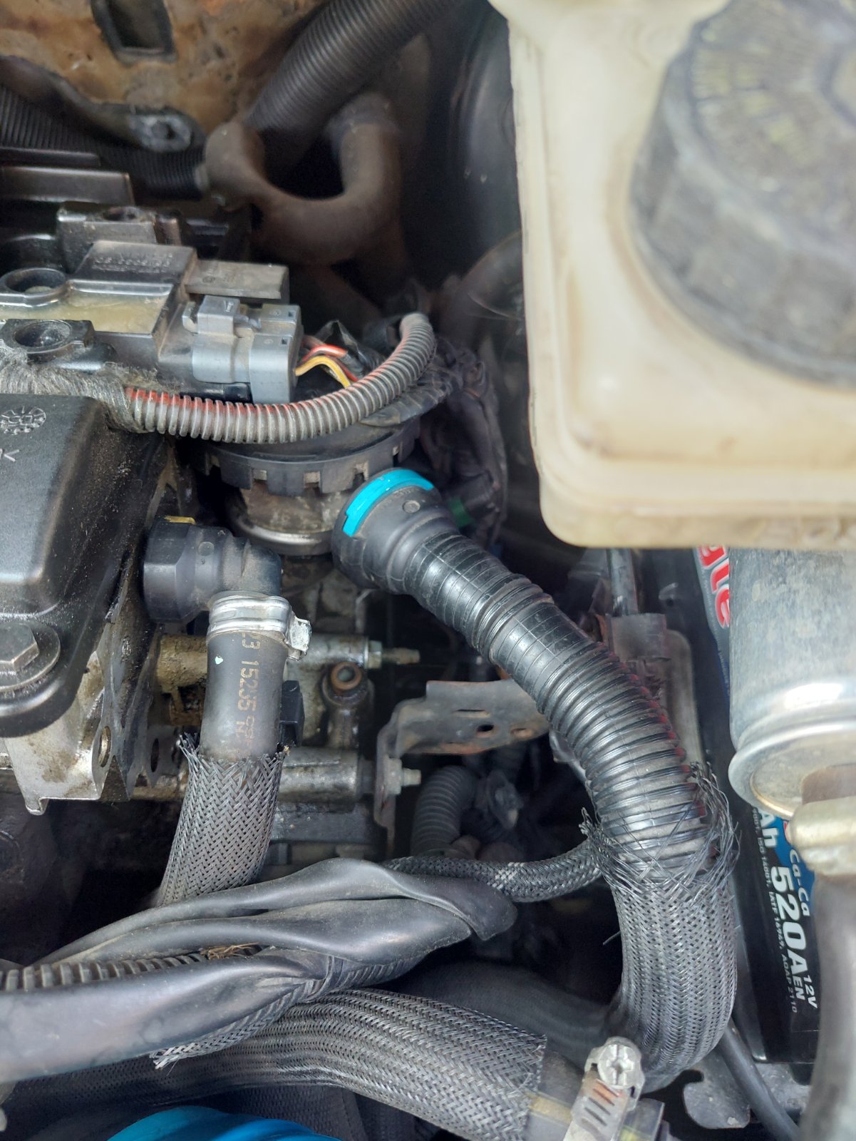

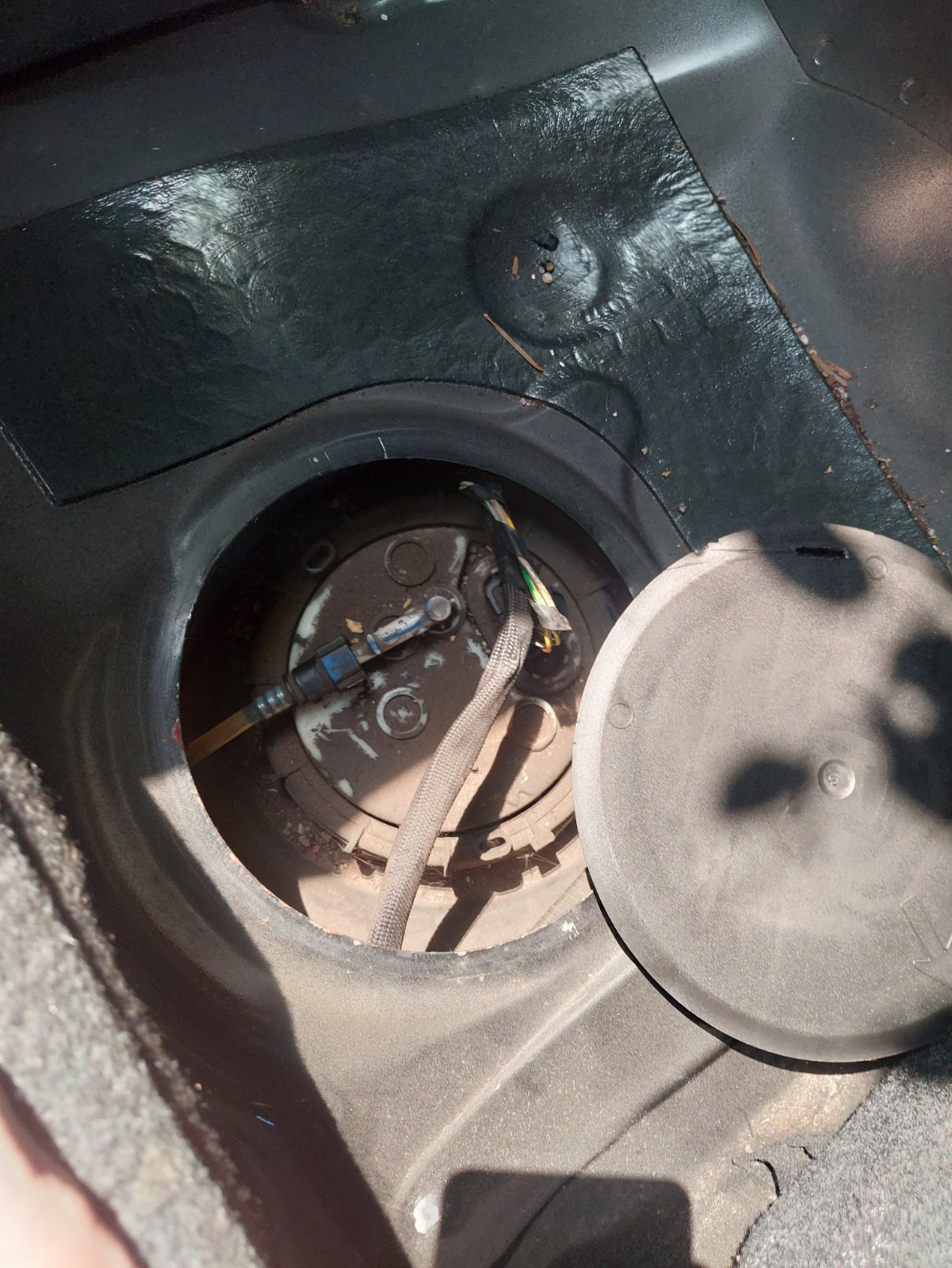

Hi guys I have a problem, the car does not start, i have checked on a fuel pump on the tube . There is a fuel but not supply to the engine. It's happend to me, the car was uphil parked, and when i started maybe it has take some air in it(was not enough fuel in the tank). What can i do now? Maybe it form a vakuum inside the engine and the pump has not enough pressure to supply fuel in the engine?
When i turn the key it only crank, its trying to start but no fuel inside the engine.

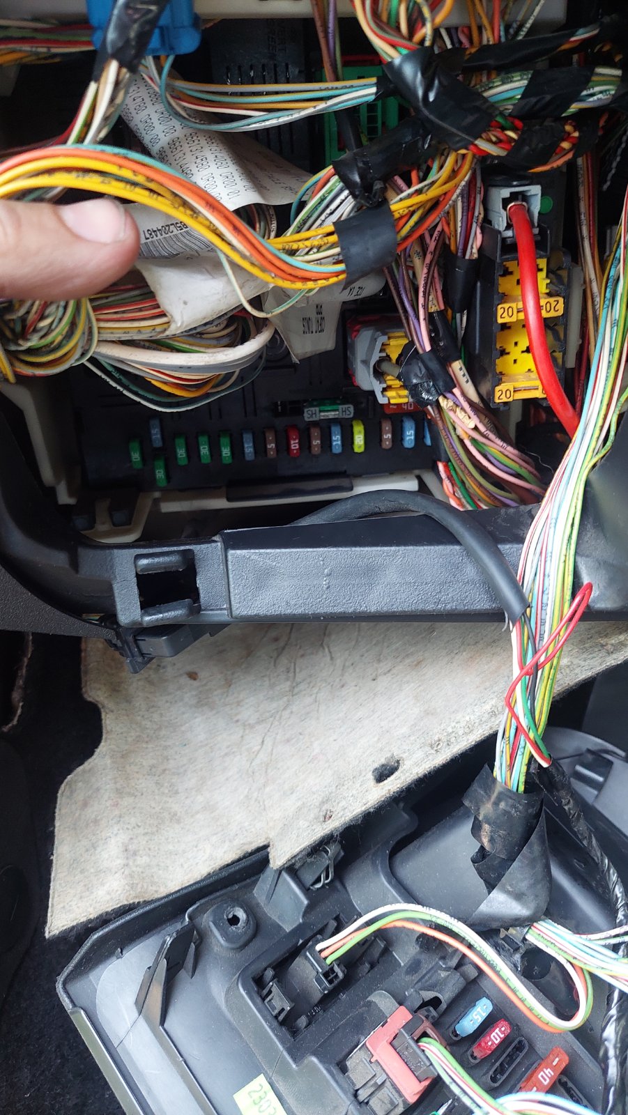

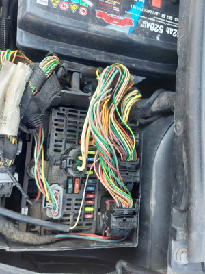

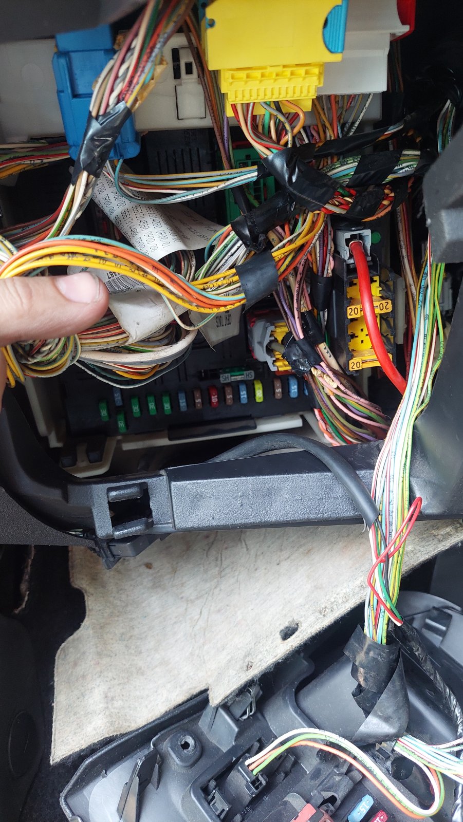

On every fuses there are some amount of the voltage, also fur fuel pump and ignogition, which is 15 and 30 amp.
On video you see from 0:13, how it starts, on tube of the fuel pump.
Thanks for your answer.
Citroen c4. Petrol 2.0. 130kw 2005 year
