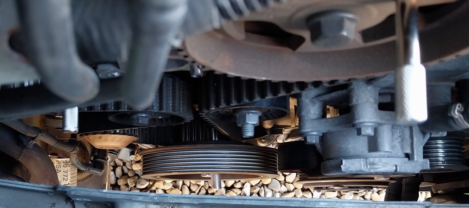

Plugged in the generic code reader and despite the dash having had an amber eml light showing, it said that there was no fault code.

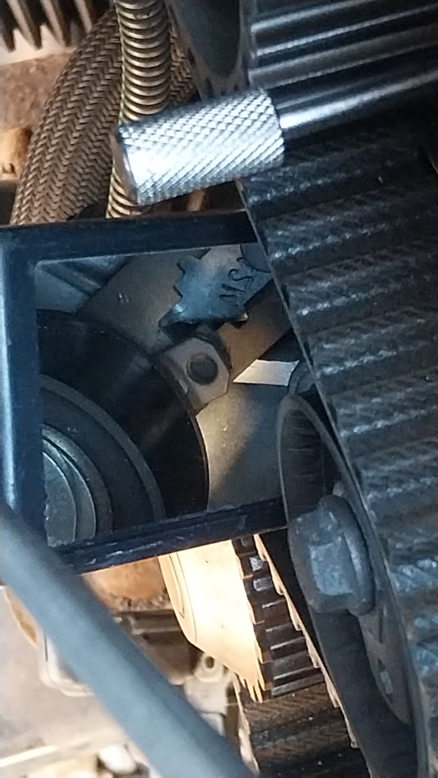

Got the crank locking pin in but the camshaft didn't line up. The high pressure oil pump also allowed me to insert the pin and the bottom lug was just clear of the hole. Then I removed the pins and turned the engine over again, this time I got the crank pin in first and it was quite loose, but again the crank didn't line up so I slowly turned the crank until I could just get the cam pin in.
The timing marks now line up but, the tensioner looks like it has slipped and has gone south of the alignment position.

Will it fire up on easy start, that will tell you a lot, if it does it will tell you that the cambelt is in tact and probably the timing is correct. If the fuel level is low you could have pulled some air into the system they can be a pig to start although if you have an 'in tank' pump it should bleed itself assuming the pump is working of course. Can you hear the pump run when you turn the ignition on? Assuming it has one.

It sounds like you need to change the timing belt and pulleys. pull the valve cover check your rockers if any are broken or out of place replace them, hopefully valves are ok. I wouldn't try to start until you are happy nothing is out of wack, you don't want to bend or break a valve that's not already bad. Unfortunately there's no easy way to check valves, but if one is bent it will smoke badly

Many thanks for the replies gents. Haven't tried any Easy Start on it yet and now I've seen the tensioner, I'll renew it before trying to get it started.
