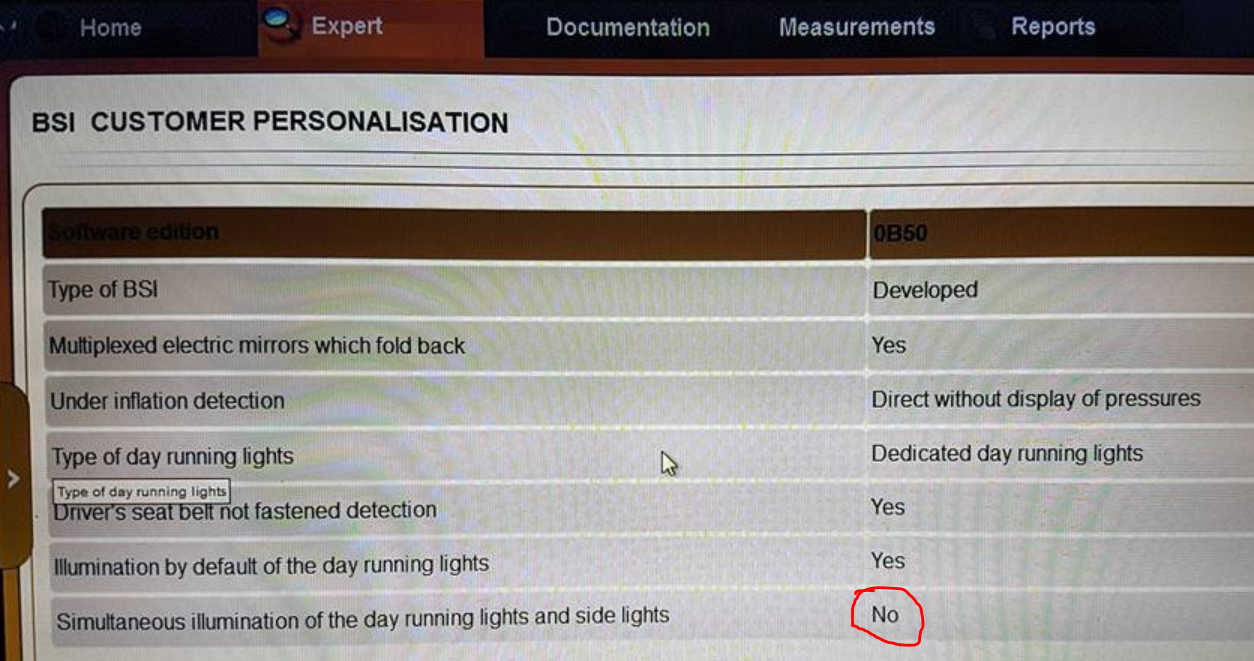

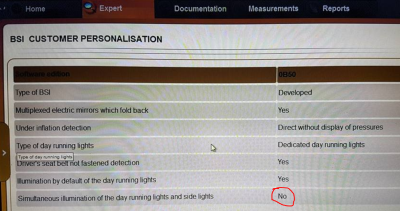

Re: C5 X7 Headlight upgrade
You have bad memory.
It´s plug and play. You need diagbox to change settings if DRL on old headlights are working same time with sidelights. If DRL is already on without sidelights, then no need for that and facelift -headlights work right away.
